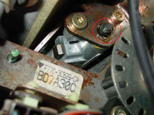

wedge yourself underneath and check the two bolts like the ones in this picture thay are a t-30 torx and are very common for them to come loose
here is the link to the thread with some info mine used to come loose all the time so i dabbed a lil blue loctite and its been almost a year now
http://www.explorerforum.com/forums/...d.php?t=228608
