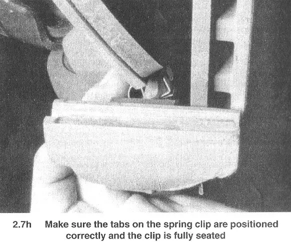

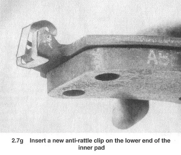

I recently did a front brake job on my '94 XLT 4x4. I now have noticed a slight metallic "ping/clang" noise and am fairly certain it's because I did not put AR clips on the inside pads. The noise disappears whenever I touch the brake pedal. Best way to describe this noise is it's as if you were tapping on the disc with a hammer.
I've searched google, this forum, and Glacier's EXCELLENT tutorial on 1st gen brakes, but have not seen any pic that shows this clip and/or where/how it's installed on the inner pad, at least specific to the 1st gen Explorer's pad.
I DID purchase from AutoZone a new caliper hardware kit that had the 4 metal/rubber retainer pins. There were also 2 small clip-looking things in the hardware bag, but the guys at AZ thought they were "squeal" clips that scrape the disc when the pads wear thin, giving audible warning that the pads are due to be replaced. mmmkay...
I've never used that type of "squeal" clip on any brake job before, so thinking they were optional, I just tossed them, along with the old pins.
Now, I'm thinking they were in fact the AR clips, and should have been installed. And this is what is now causing this noise.
At the risk of redundancy...does anyone have a pic of these clips, and where they are to be installed? I suppose the inner pad will NOT fall out, as it's retained by the grooves in the caliper bracket and the piston. But it's annoying, especially following an otherwise good, new brake job.
