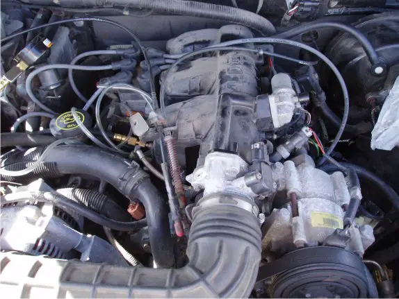

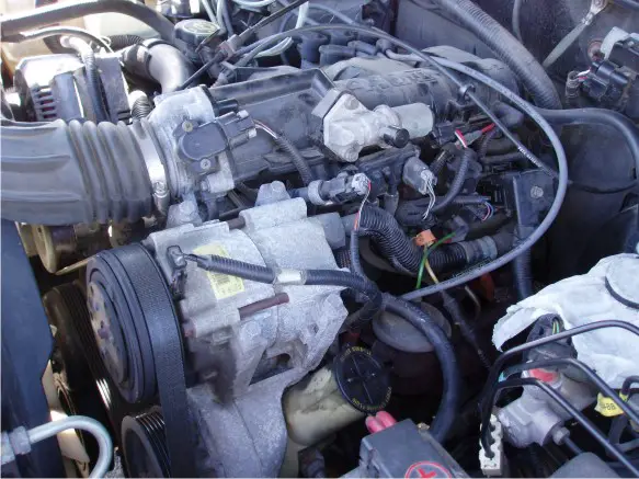

I attached a three pictures so someone can help me identify my engine. One of the pictures is of the pressure regulator or damper. I would appreciate help in identifying this object also.
the OHC did not use a fuel pressure regulator as such bet rather controlled the pressure by controlling the current to the pump.

If it is the push rod engine there will be a regulator in the tank. I have service manuals for 99, and will assume they apply to 2000 as i know they made changes in 99 and likely would still be the same for more then one year.
This pump assembly is only two or three months old. It better not be the pressure regulator in the tank!

Using the vin code your engine is an OHV 4.0 liter...On the plastic upper intake it will have "4 liter EFI" molded into the casting... I do have EFT molded into the plastic cover on top of my engine.
There will also be no cover on the intake at all...

That is the OHV engine. That is not a fuel pressure regulator.
EE
Agreed, that is the OHV motor. Weather it is a fuel pressure regulator or damper, have you replaced it? Whatever the case is, that device is responsible for controlling, or regulating the pressure on the fuel rail. My Chilton's manula calls it a regulator, but let's not get into the tomato potato war.
The fuel pump just spins, creating about 65 to 95 psi. That device controlls the pressure by limiting the amount of fuel being sent back to the tank. If it's stcking, either open or closed, that will cause dramatic spikes, high and low, in fuel pressure. This could have been your problem the whole time.
