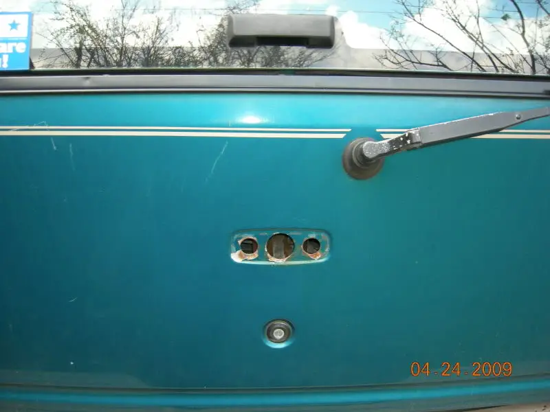

i ended up taking the handle off 2 bolts from the inside. yes i trashed the inside plastic cover doing it. but now i stick my finger in the hole to the left slight down up gets the glass . to open the gate i pull the rod that goes from center of gate to drivers side and it opens
uploading pics now.. lol
no handle
inside view. if i could change font size i would.. lol zoom in to read it
video of glass
another note.. how to remove the handle without trashing the plastic cover. so the glass will open.. propane torch. the handle is plastic heat it up just a little bit and the studs will pull right out. just enough heat to soften it up the studs are pressed into the plastic handle similar to a wheel stud.
