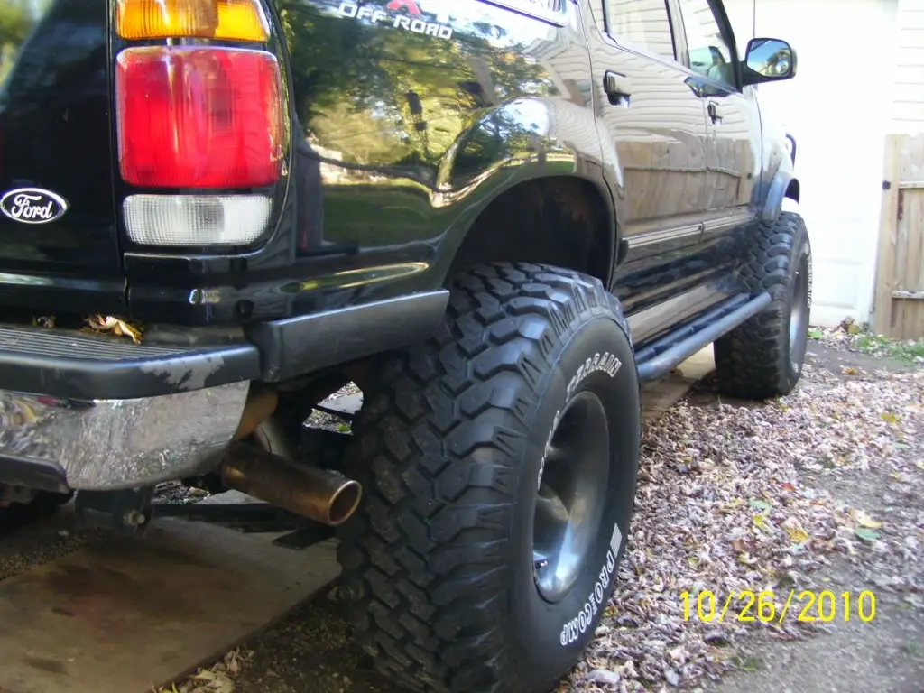

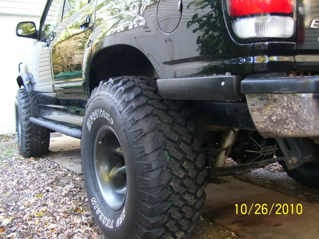

Quote:
Originally Posted by corkey View Post
did you cut at the back too, ??
The front of the rear wheel wells looks fine, it's close but as long as there is no forward movement in the axle, everything should clear at full stuff.
The rear of the wheel well was a different story. At full stuff, the tire would definitely rub the fender. For street use, its fine.
I did remove some sheet metal to eliminate rub at full stuff. The chrome piece removed and all the fender metal was cut off below the trim line. Nothing new, as lots of people do this. The new bumper will wrap around some for protection. I do believe the exhaust tailpipe and tip has to be moved now.
As usual, do one thing, you end up having to do multiple things.....For every action, there is a reaction, ie...******!!

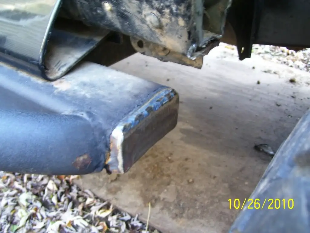

(Original Poster)

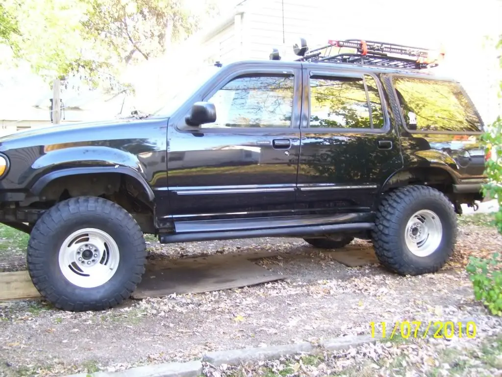

Been busy, but managed to get home before the sun went all the way down today
Slider caps welded back on. Not painted yet, but soon.
Fender chop.

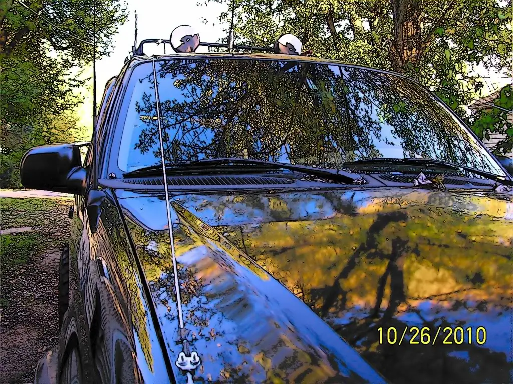

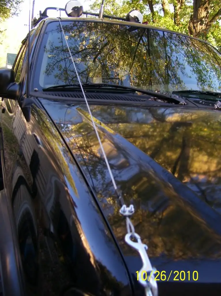

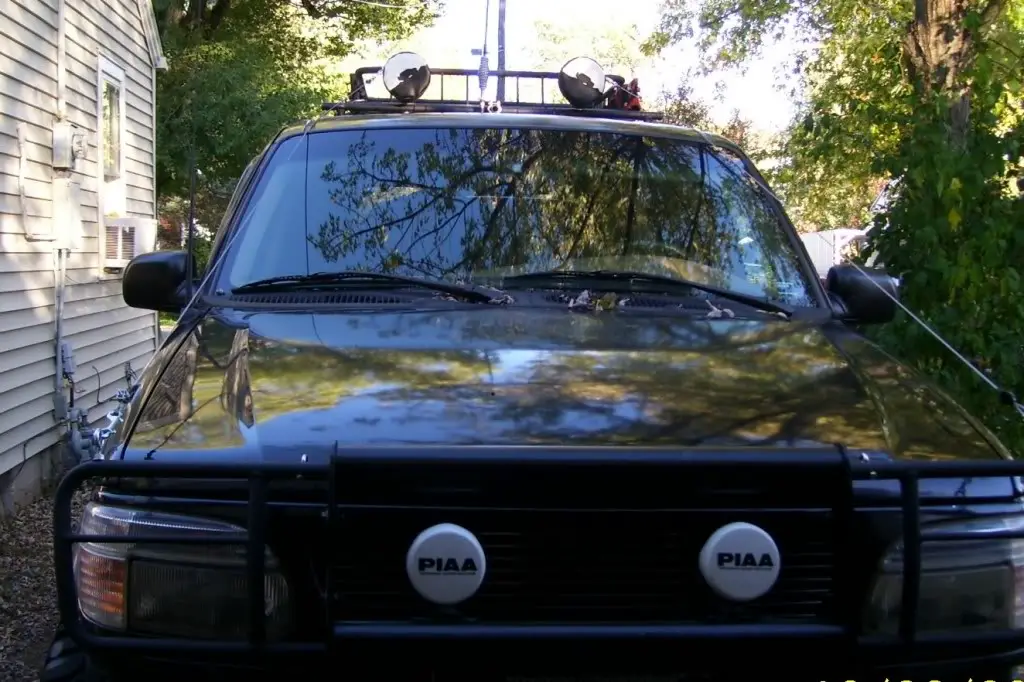

Cable brush protection for jungle wheeling (Midwest US).
Once the bumper is installed, it will have separate posts to connect the cables to. They are connected to the brush guard and the roof basket for now. They are completely removable in seconds. Stainless turnbuckles to tighten and loosen for install & removing.
Used a set of marine clevis tie downs for cable guides. These are held on with epoxy to the windshield weather seal. Their only purpose is to stop the cable from carving a groove in the roof.

So will those cables keep people from being smacked by branches?
Looks like a good idea.

keep them off the windshield,

Yes, those cables will provide some protection for the windshield and help with a good field of view when going through the thick. They will hopefully divert branches away from the glass, & hood.
They are so simple to remove, and hook up, it will be a snap to slap them on before heading out on the trails.

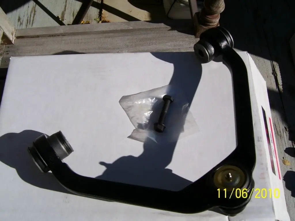

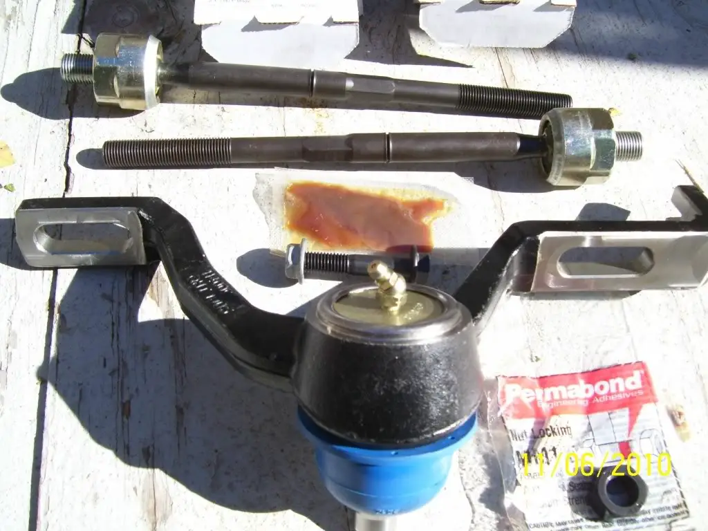

Took the rig in for an alignment. Had a dr side tire wobble. Thought it was the outer tie rod end. I brought a pair of them with me to have them installed before the alignment was done as to not have to worry about setting the toe and driving it to the shop. Simple, all good right?.......NOT!
Once on the lift, we discovered some bad news bears parts. Both new (couple of months) upper BJ's were toast. The weak stock inner tie rods were junk. Dr side was barely on at the joint. Thus the bad wobble. The outer tie rod ends were fine, so they were returned.
I ordered the Mcquay/Norris extreme inner tie rods, and a M-N pass side upper UCA/BJ as that is all I could find being sold anywhere. I ordered a new HD M-N version sold at Napa for the Dr side.
The alignment shop thinks the steering rack gear is shot, the shop that installed it (2yrs ago) says its fine. We shall see who is right and who is wrong after the parts are installed and the alignment done.
