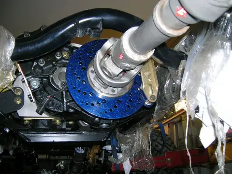

Anyone every run one of these, or know how effective they are as a parking/emergency brake?

Quote:

Posts: 5,407
Vehicle Specs
Isn't Izwack running one of those on his t-case?
Dannyboy is offline   Reply With Quote

Quote:
They work pretty well - cauz the ring/pinion gear effectively multiplies its holding torque by whatever the gear ratio is.

Quote:
It also can run VERY hot, due to that multiplication factor.

I just need something to use as a parking brake, since my rear disc conversion uses front calipers.
Which calipers?
The big problem with the pinion type brakes is bent rotors, and stuck or dragging calipers..
I have a toyota kit I need to sell, which has the rotor/caliper..

I'm using front calipers and disks from a '87 GMC V2500 4x4.

Isn't there a Caddy kit that has parking brakes built in for the 9"?

I've seen some caddy kits, but the brackets I have from Ballistic Fab are for '78-87 GMC 3/4 ton fronts.

Quote:
There are a few of those. I put it on my 9" before i sold it. Worked out pretty well too for a retro fit.

If you don't do the tcase brake, are you going to try linelocks?
I know from personal experience, no parking brake SUCKS..

On a manual transmission, the no parking brake thing would suck, but for us slush boxers, the parking pawl works pretty good. I used the manual line lock from Summit Racing so as not to kill my battery for extended parking, but I rarely use it unless I am on a steep hill or something.
