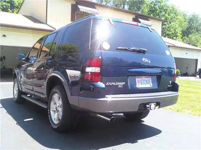

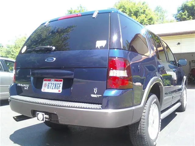

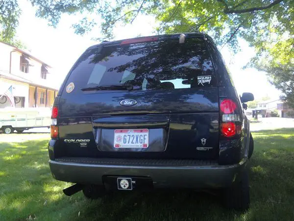

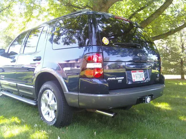

We....I got my birthday present...'06-'08 tails....and got them installed. Little more changing stuff than I though but well worth it. I had to change over 2 mounting tabs on each side, change to a new style reverse light socket and add the 3rd socket to each side. Also all the bulbs for '06-'08 Explorers are different so had to buy all new bulbs. I spiced the top light socket (running light-194 bulb) into the parking light wire for the bottom socket using heat shrink butt connectors and then changed over the reverse light socket using the same connectors. Then after all was done I went to mount then the the mounting screws are different so found 2 misc. screws to hold them in untill I could get the right ones from Ford. Sorry about the cell pictures..tried different angles to get rid of the glare. That should be all the mods I'll do untill I get my hood painted and the '04 Mustang GT hood scoop painted and mounted in July. Lemme know what ya think of the lights.
