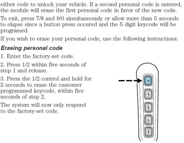

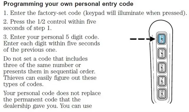

IDENTIFICATION:
1. Production installed keyless entry keypads are mounted flush with the surface of the vehicle and are wired directly to the module controlling the vehicle's keyless entry system. This style keypad can be diagnosed using the appropriate Workshop Manual (WSM), Section 501-14.
2. Dealer installed GFA RF keypads are adhesive backed and protrude approximately 1/2" (13 mm) from the surface of the vehicle and there are no specific diagnostics available in the WSM (Figure 1).
NOTE THIS RF KEYPAD WAS ALSO US[D IN PRODUCTION ON 2004 F-SUPER DUTY VEHICLES BUILT PRIOR TO 12/3/2003. REFER TO WSM, SECTION 501-14 FOR RF KEYPAD DIAGNOSTICS FOR THESE VEHICLES.

2. The GFA RF keypad is serviced as an assembly. The internal battery cannot be replaced separately.
3. If the master code or owner selectable code is lost or forgotten, the GFA RF keypad must be replaced. These codes are not stored in any vehicle module (with the exception of 2004 F-Super Duty vehicles produced prior to 12/3/2003).
