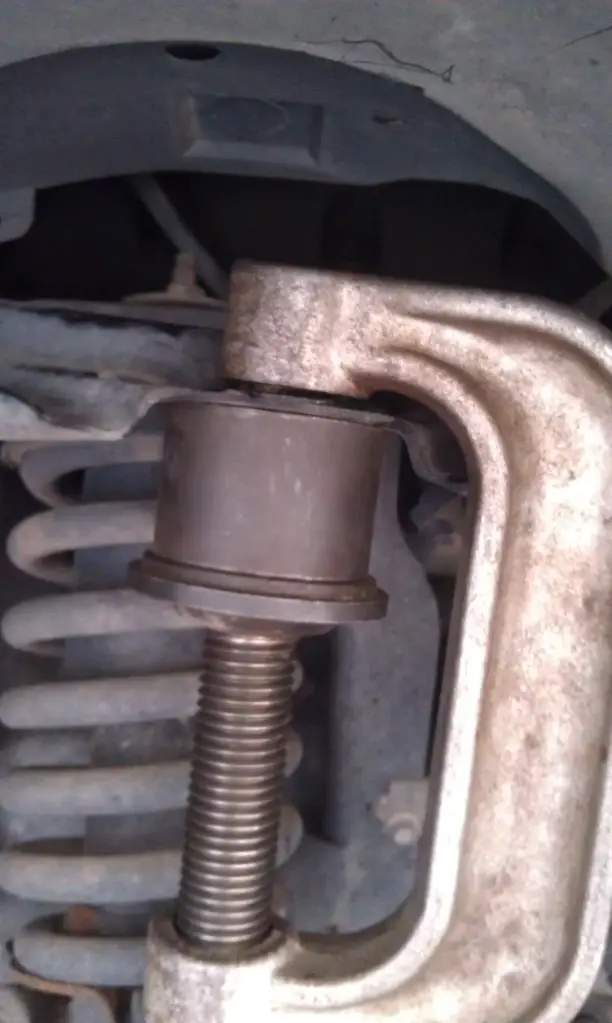

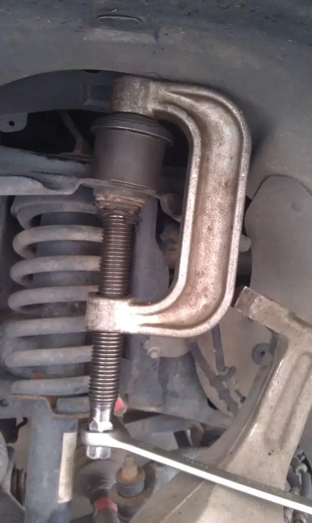

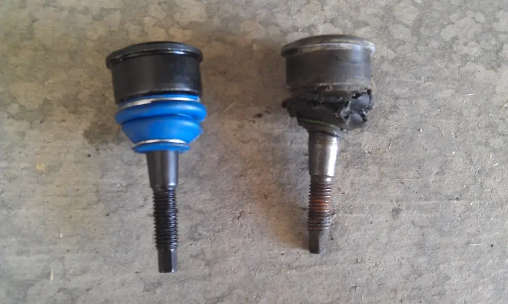

Posts: 3,087
Vehicle Specs
Here's what I used and I didn't have to take the control arm off.
Pressing the old one out:
New vs Old:
Pressing the new in:
Done:
