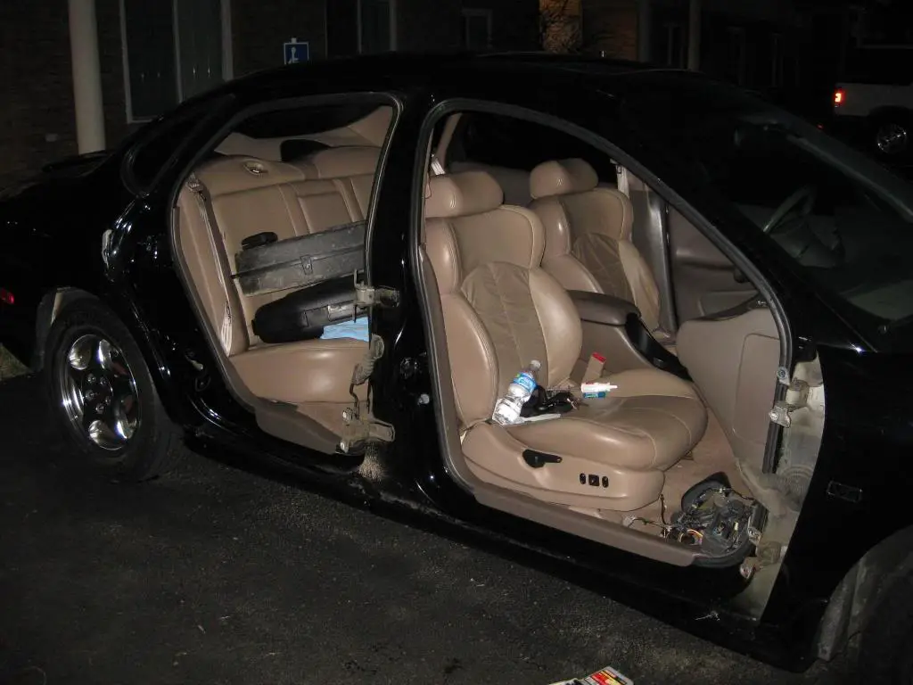

This is what happened:
So this is what I had when I got home and peeled the NASCAR tape off.
