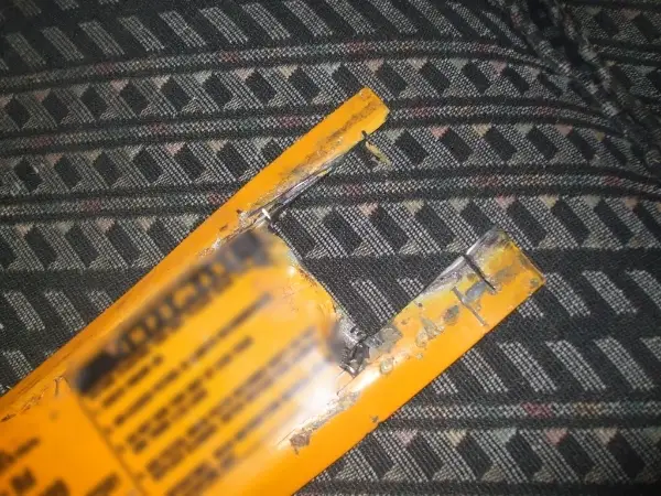

I just used the rental tool from AutoZone. The large squarish one (58mm) has to be held in position then the other one (36mm) can be used to loosen the nut on the fan clutch. When I got the two wrenches properly positioned I used a dead blow hammer on the 36mm one and it came loose pretty easily. Getting the two wrenches properly position depends upon how you are going to whack the smaller one (Are you righty or lefty?). I used my left hand to hold the big 58mm wrench firmly around the four bolts on the pulley and made sure the other wrench was at an angle where I could whack it without hitting A/C related stuff.
coopa
P.S. I had to return the 1st tool set to Auto Zone because the 36mm wrench was "spread" to 39mm and would not grip the clutch fan nut at all. Probably because a previous user tried to loosen a LH threaded clutch fan as if it were a RH thread...or vice versa.

I had the same experience with tool rented/borrowed from Advance AP. The difference between 36mm and 1 7/16" is insignificant, especially since a regular combination wrench is likely to be considerable beefier (thicker) than the tool from Advance. Advantage (pun intended) 1 7/16". I learned a long time ago that there are several inch (SAE) equivalencies compared with mm wrenches, with the caveat that if the substitute wrench is a little bigger (13mm compared to 1/2") you might round off a really tight nut or bolt, but most of the time it will be OK. I recently purchased some of those ratcheting combination wrenches and was disappointed that the SAE set has a 7/16" and the mm set has 11mm. Dupllcation. Oh well, at least I'll still have one when I lose the other.
The homemade fan pulley holding "wrench" pictured above in this thread should be pretty easy to replicate, in fact I'm going to get my favorite welder to make one for me out of some scrap steel. I'd do it myself but he's a wizard and cheap to boot. The tool in the Advance AP set is marked 58mm and if you look around the web for this tool you'll find in listed as 57mm, 2 1/4", 2.3", and perhaps other. The point is for the job it's designed to do precision is not an absolute.
