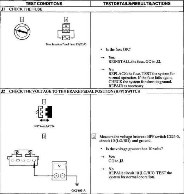

edit: can't seem to find this module anywhere on an 01. Last question... no power at rear lights even with parking lights, correct?
sounding more and more like a broke wire.
one more edit: on the brake pedal position sensor, 2 terminals are hot at all times, and 1 is output to stoplamps. Pin 3 (BN) and Pin 5 (LG/RD) are hot at all times. Pin 4 (LG) is output to stop lamps.
I lied, edit again: you said hazards DO work? ugh... hazard/turn flasher is the same flasher unit. Maybe the BPP sensor then.

brake lights, the BPP could be a possibility, follow the diagnostics I posted.
