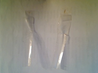

I did it! After looking at the rear seat head rests on a '98 X like mine, I could see that the detent spring thingy was only locking on the back side of the rods. So, I cut up two 3-inch pieces of that clear plastic from a cat-toy package, and slipped them between the chrome shafts and the hole. Then I forced the head rest downward to get the plastic "tool" between the shaft and clip. Finally, I worked the head rest upward while keeping the plastic "tools" from rising. Voila! - The whole process only took about 15 minutes, including making the plastic "tools".
My rear seats are now headless, and I can finally have the rear seats folded and adjust the front seat all the way back plus recline!

Here is a picture of the plastic things I made up:
