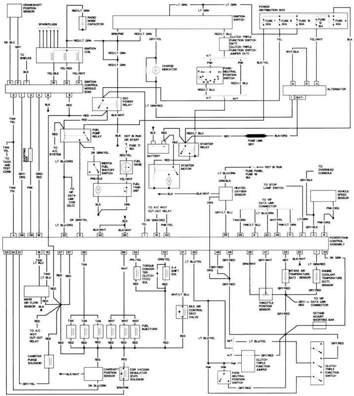

In the process of trying to fix my (unrelated) A/C problem, I picked up a wiring diagram from the forums and noticed that the WOT A/C cutoff relay goes to the ICM (ignition control module), which has a lead labeled "to tach & test conn."
Is that lead going to the tachometer? Would an erratic tach indication correlate with an ICM fault?

Do you remember which ICM code you got? Crankshaft Position Sensor (CKP) feeds the ICM with engine speed data, and then, as noted, the ICM sends that data to the PCM and Tach. With the ICM code and the inconsistent tach, it suggests that there is something bad between the CKP and the PCM. At this point, it doesn't appear that you've done enough diagnosis to determine if it's the ICM itself, or the wiring, or the CKP, but it sure looks like the right area to start.

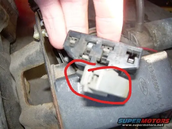

FYI:
This is where the "Tach and Test" wire terminates. At the EEC-IV test port.
NOTE: Can be used to test the PIP (CPS) signal using a low voltage probe. Also can be used as trigger for a tach or timing strobe. 5V saw tooth _/\_/\_/\_ on an oscilloscope.
