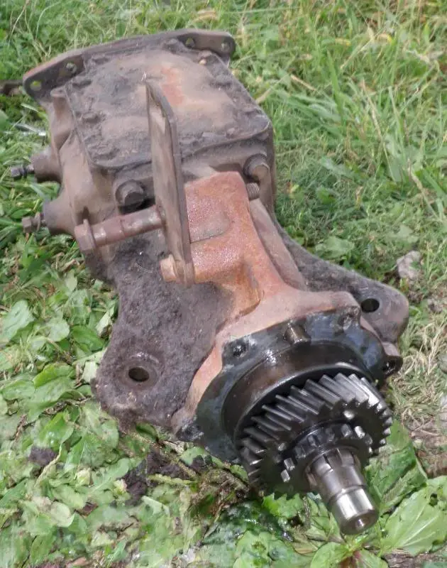

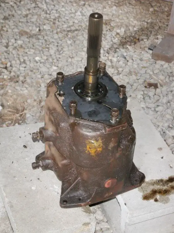

I'm just getting started with this. It's also tied to my SAS (http://www.explorerforum.com/forums/showthread.php?t=237798). I plan on cutting up my existing manual shift BW1354 to be the low range box. I scored a good deal on a Ford 3-speed and "T-shift" Dana 20 from an early Bronco. The T-shift has the more desirable 2.46 low range. In low-low I'll have a ratio of 6.1:1.

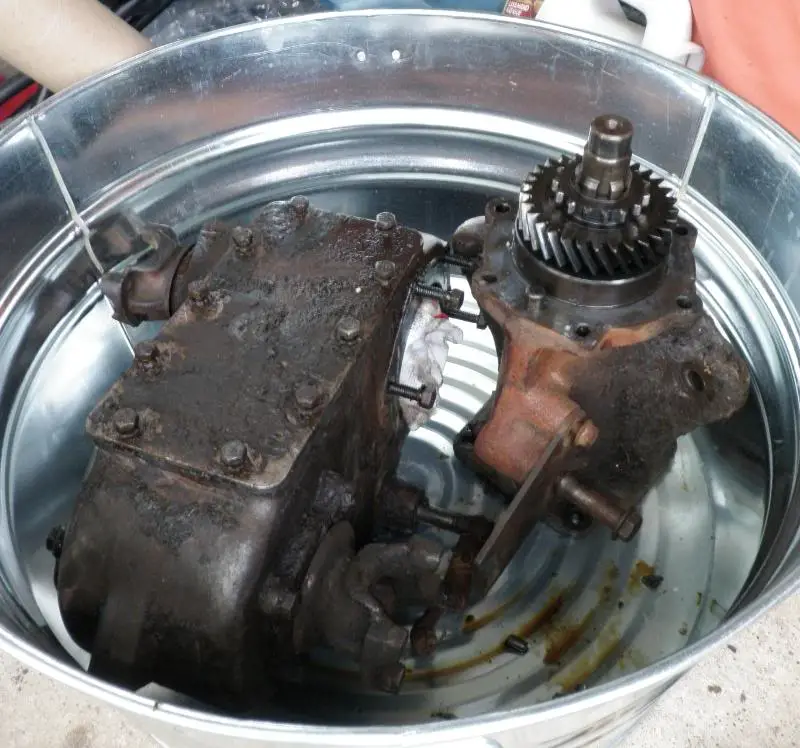

This stuff was/is still filthy! Almost 40 years of gear oil-based mud and muck:

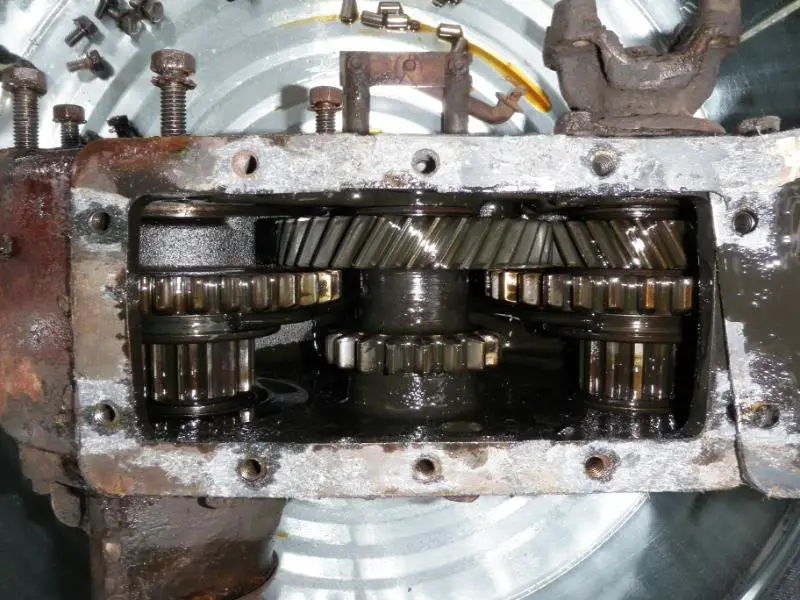

The inside of the case looks good, though!

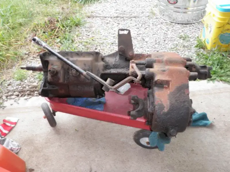

Here's the 3-speed. I'll be pulling the shaft and gear to go on my eventual spud shaft.
More to come!
More to come!
