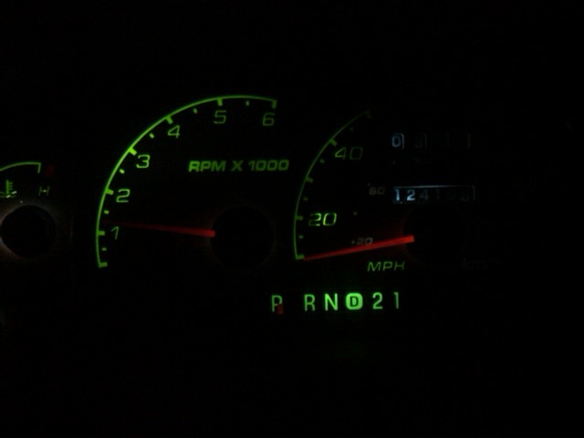

Awhile back I got some LED lights for my Insturment Cluster (I have a cluster out of an 01 Sport, white face gauges).
The lights worked for awhile, but after a few months they went dark, to the point I couldn't see my speedo (only 1-2 lights went out) however they came back on. They've been going on/off ever since, so I know they are not burnt out.
Anyways, lately the lights that light up the speedo section of the cluster have been out completely, so I can even see the speed past 40 MPH at night.

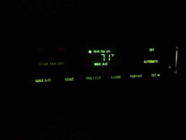

Also, for whatever reason - the lights behind my HVAC unit are doing the same thing. This is more rare, but it still happens. They come on/off at different times.
I wonder if the LED lights are requiring more voltage than the OEM lights? Could this be the issue?
Should I get some new lights? I would like to get a new cluster altogether. Is it possible to install a cluster in a 98 Explorer where the gauges themselves are lit? (Like an 03/04 Cobra gauge). Right now its just the digits that are lit up.

LEDs generally don't like to be dimmed. They require a certain threshold voltage to illuminate. Some can be dimmed, but in general, they can't.
Just curious though: What's wrong with using bulbs? THe bulbs in my Ex (11 years old with 174,000 miles on it) are still, for the most part, in good shape. The fog lamp and rear defrost switches' bulbs went out a few years ago, but the IC bulbs have worked fine up until one started winking out just a couple weeks ago.... I figure that if they made it this far, the replacements will out-last the truck this time.

I went with LED's to make my gauges brighter. I didn't like the dim 'yellow' look from the OEM lights.
Are there any other bright white lights I can use besides LEDs? Or any lights at all that won't go on/off?

You could replace the (6) original bulbs that illuminate your instrument cluster with Pure White SMD 168-194-SMD-5-LED's. You can get them on Ebay and believe me there is a difference of brightness in what the seller supplies.
I got mine from this seller a while back
http://cgi.ebay.com/2-x-White-168-19...d=p3911.c0.m14.
Again, there is a difference.. I bought my first SMD 168-194-SMD-5-LED's from etherwholesale who sells the LED's in the link I gave you. A few weeks later I snooped around Ebay and purchased the same identical looking LED's for less money. I thought I got a deal... I can see the difference in the brightness of the two bulbs. Spend a little more and get them from etherwholesale, they are quality bulbs and very bright.
You will need to pull out your Instrument cluster to get at the (6) bulbs.
It is not very difficult. Here is a link showing the removal step by step that MustangP51 took the time to post on the forum. http://www.explorerforum.com/forums/...=1#post2160406. You will need to scroll to the top of the page.
One photo shows the instrument cluster at a work bench with some power leads attached ...you do not need to run power to the instrument cluster if you do not want to...I didn't. That picture I am pretty sure was for checking the clusters illumination when the bulbs were changed to LED's.
Just take your time, go slow and when the job is complete you will see a big difference.

I forgot to mention I am pretty sure you need just (1) bulb in your EATC(Electronic Automatic Temperature Control) unit to light up the blue and red temperature manual select buttons and Rear Fan Off etc.
The EATC is easy to remove and I am pretty sure you can buy the replacement bulbs at any automotive parts store, they are not LED's just plain old everyday stock bulbs.

O.K. great, thank you for the info on the type of bulb you need. This makes the bulb search much easier. For some reason different types of bulbs were used on the EATC's.
On the circuit board 5 bulbs are used for illumination ( 3 on the bottom) that light up the lower select buttons MAX/AC - VENT - PNL-FLR - FLOOR - FLR-DEF - DEF
1 BULB (LEFT SIDE) that light up the BLUE - RED COLORED TEMP UP DOWN SELECT BUTTONS AND REAR FAN OFF BUTTON BELOW IT.
1 BULB (RIGHT SIDE) that light up OFF and AUTOMATIC BUTTON BELOW IT.
