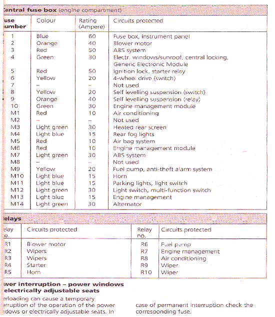

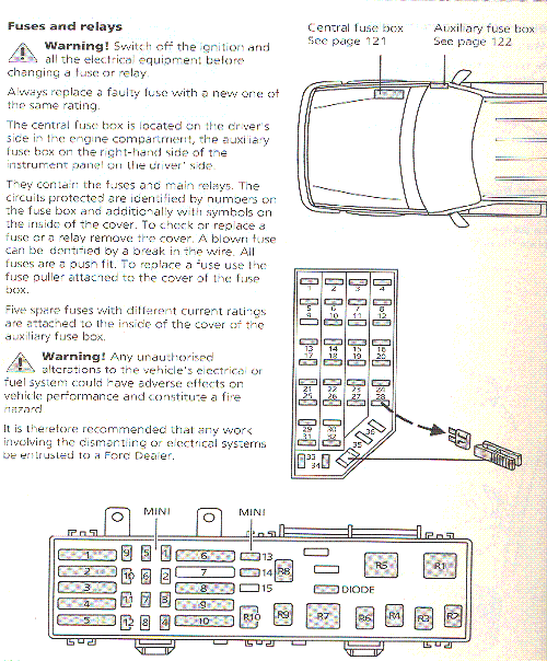

i have a 1998 ex , my distribution box looks northing like the one in owners manual, it looks simuler to a lincoln can any one but me right
i need to no which number fuse the self susp r and which relay for the sme thing, and does it look sim to a licoln maybe u can point me to find a diagram
thanks

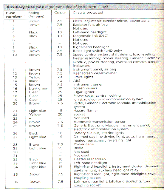

Hope these help.
