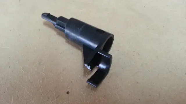

Even though old this thread was very helpful for me with my daughters Explorer. I had the same broken arm so I came up with a similar solution as above.
If you give the broken arm a little tug it will pull out. Be careful not to dislodge the defrost door in the box. It makes it a lot easier to work on the bench.
I cut the brace part off.

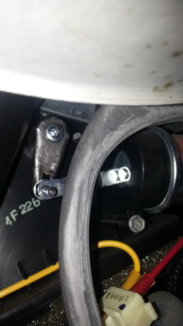

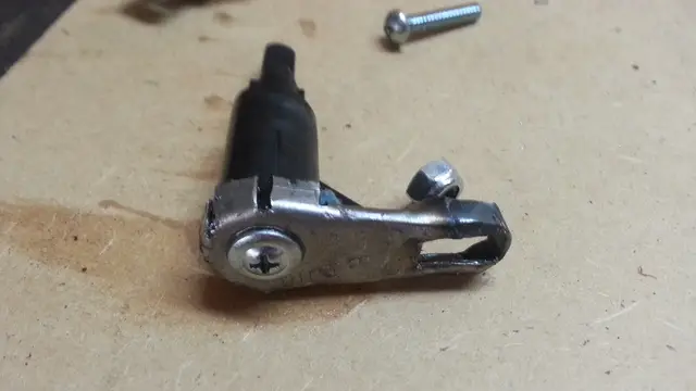

I took some 20 ga sheet metal and cut out a piece slightly larger than the broken tab.
Then with a hammer and piece of metal I bent the sides over and drilled a slot for the mounting bolt.
I filled the original piece with 5 min epoxy and put a 1 5/8" screw in the epoxy to hold the tab in place.
For good measure I folded the bottom side over to secure the new piece to the old piece.
Then using a #10 machine bolt with a nylon lock washer I bolted it to the vacuum pod. I left it loose enough so the pod arm had enough room for it's entire travel without pulling on the door arm.
It works like a champ now. The only problem I have left is when the switch is set to anything on the right side of OFF it blows through the defrost as well as the floor or vent. If you turn the switch left of off for the vent/ A/C then the defrost closes like it is supposed to.
