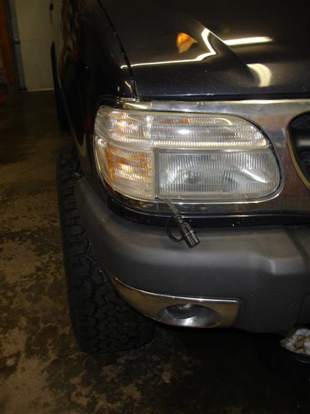

Well, the install is done. I will upload some pics later.
I should have pulled the lower radiator hose to get more coolant out of the block. The radiator was drained, but there was still a ton of coolant in the block. When I spun the freeze plug it was like Niagara falls. lol Drain pan caught most all of it though.
__________________

sorry for the rant, but i would have put the cord through the opening of the bumper. that way when the wind and what not wont beat up on the head light. my 2 cents thats all. great pics by the way. how long did it take to put it in?

Yeah, I am not completely sold on the location I chose for the cord. I wanted it in that vicinity for convenience because of the way I will be parking near the outlet, but we will see. All I have to do to tuck it away in the warmer months is pull the parking light out and put it behind.
I know the factory location is in the bumper opening but I wasn't a fan of that spot so I tried something different. It is easy enough to move if I decide. I don't care about this truck the way I care about my sport. If it works and does not make annoying noises I could care less about slight cosmetic damage. Heck, I have a 4ft long crack in the windshield, haha. Gonna get to that soon...
The install was incredibly easy with the body lift. I didn't even jack the truck up or remove the tire to get access into the wheel well.
I just drained the coolant and then hit the edge of the freeze plug with a large flat head and hammer. It spun 90 degrees and I pulled it out with a pliers. Then I cleaned the opening out to make sure there was no debris. I put a little rtv on the outer metal lip of the block heater, not the o-ring itself. This will seal against potential corrosion getting to the sealing surfaces down the road. Popped it in, tightened the bolt to expand the tabs that hold it in, and routed the wire. I put some split loom around the cord that I had in the garage just to protect it more. Refilled the system, and done. Have not tested it yet.
