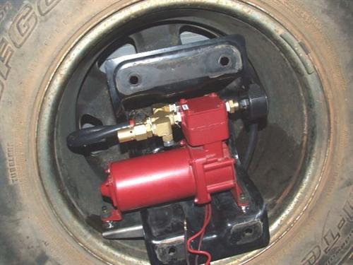

I run an mv50 compressor, as do some of the southern Ca guys.
One thing I did noticed, the quick coupler on the compressor isn't the normal quick coupler you would expect on the compressor side. I pulled that fitting and put in a normal quick coupler on ours. Now I can run a typical air hose on it. Also it takes about 6 or 7 minutes to take a 33x12.50 tire from 13psi to 35psi. When your done, you need to let it sit for a bit to cool off if your going to put it back into a bag (not an issue if hard mounted). Also, they do draw quite a few amps at startup, especially if they are starting against the pressure in a tire (say 40 psi like on a low trailer tire). I've changed the fuse holder on ours to a higher amperage one since the old fuse "holder" melted when I used it for 3 sets of tires. Overall though.. the mv50 is a good compressor. Of course, I've gotten lazy and impatient in my old age. .I'm using co2 now. ~Mark |
#395 |
Down Under Beer Explorer
Albany, Western Australia
2004 XLT V6 4x4
I was abit worried about the heat compressor's put out when looking for a place to put mine and I read something about venting them to the outside so there is no oil smell when they're in use(?) There was a spun out idea on some blokes jeep down here where his compressor fit's right into the rear mounted spare
