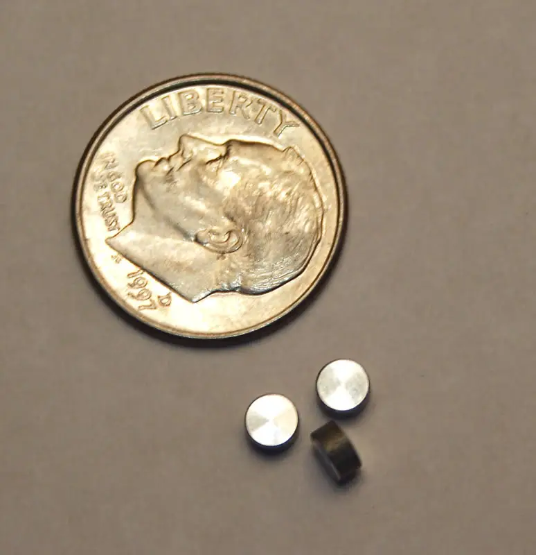

Hey guys, I found these three metal pieces at the bottom of my transmission pan today. Dose anyone recognize them. I don’t want to say it, but they look like bearings to me. Just wanted to check and see if anyone else could shed some light on them. it's a 2002 ST.

How lucky can you get, Hoorawflyguy.....:D

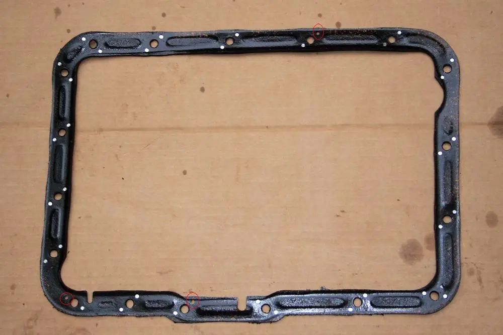

Same thing happened to me when I dropped my pan...Scared me for a minute, then I noticed about a dozen more of those on the gasket, and saw a few were missing. Whew!:chug:
Tell me about it. I was in panic mode yesterday.
Thanks BrooklynBay, that's the response I was hoping top get. ;)
I pulled my old gasket out of the trash and it did have three pieces missing. :)

I had read that the pan contains a magnet to stop filings going back through the transmission. So on discovery of the little metal pieces pictured above I thought they had something to do with that. so left them in the pan.
Thankfully I have still not yet refilled the trans with oil. Should I go to the effort of removing the pan and getting these few pieces out, or would they be heavy enough to sit harmlessly at the bottom??

I did clean the magnet.
what I left in there was a few metal pieces from the old gasket..
Should I pull the pan back off or do you think they will sit harmlessly at the bottom.
Cheers.
I'd take 'em out if it were me.
Whew!!!! What a sigh of relief, I just dropped the pan and changed the filter and fluid on my 98 Explorer and found 6 of these in there and was just fixing to post them up to see if anybody knew what they were. I knew they were not magnetic but did not feel like aluminum either and was fearing bearings as well! Thanks for a great forum and being able to find answers so quickly. I was really worried even though the transmission is shifting well.
