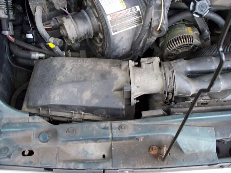

Routine maintenance falls into many categories such as replacing spark plugs, cables, air filter, breather element (if equipped), cabin filter (if equipped), fuel filter, cleaning battery terminals, fluids, etc. There are other things which are just as important, but don't usually get cleaned such as the mass air flow sensor, idle air control solenoid, PCV, and the air charge temperature sensor. Those parts either get cleaned or replaced once there is a problem, but not as preventative maintenance.
This is the mass air flow sensor on a 1995 Aerostar with a 3.0L:

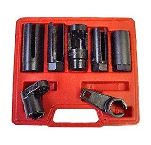

Another neglected part of maintenance cleaning is the oxygen sensor. Some are easy to reach while others are a major project to remove. As technology progresses, the vehicle's computer requires more precise metering of the proper fuel mixture. Older vehicles had a single wire O2 sensor while others (such as my 95 Aerostar) have a 4 wire sensor. Some vehicles have 4 oxygen sensors making things even more complicated. To start, you will need the proper tools to remove them. Here is a master tool kit:
This is a crow foot set:
This is a heavy duty socket to remove stubborn sensors:

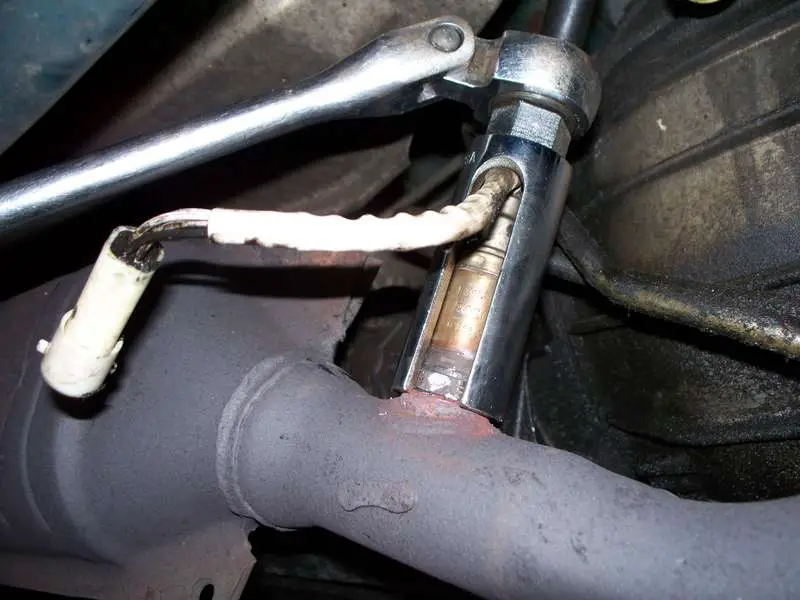

This is a socket made by K-D tools on top of the oxygen sensor:
This tool uses a 1/2" drive ratchet. If you see that the sensor is stuck, one trick is to loosen it, then tighten it, then loosen it again. The twisting action will help break it free before the socket breaks first. The sensor should be sprayed with a cleaner such as MAF cleaner, intake cleaner, or electrical contact cleaner. Only use O2 approved chemicals. Anything else could damage it. Anti-seize compound should be used on the threads to prevent it from getting seized onto the exhaust pipe:

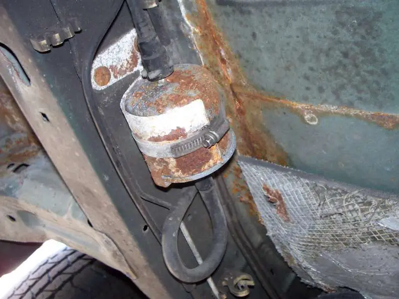

The fuel filter in the Aerostar doesn't require any special tools to disconnect. The fuel lines have small clips which disconnect with a small needle nose pliers or a flat screwdriver. Here is a picture of the fuel filter on my 1995 van:
The filter was stuck on one of the fuel lines. I had to use a wrench as a pry bar between the fuel line, and the filter.
I used a bench grinder to cut the old filter open. Here's is an internal view of the paper cartridge:
As you could see, the cartridge is very dirty. I had a rough idle, hesitation, stalling, and hard starting. It seemed to happen after I filled up with gasoline a few weeks ago. I suspect that the gasoline was either contaminated or watered down. I used a bottle of fuel system cleaner, and it was a little better, but not perfect. A week later, I added another container of fuel system cleaner. It was a little better, but still not perfect. I could tell that there was still some restriction, and the fuel wasn't flowing in a steady flow. It felt like a series of surges instead of a continuous flow. I bought a new filter from Autozone. The part number is FF679. Here's the new filter:

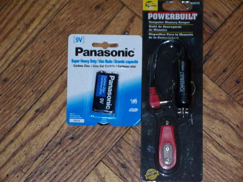

Corrosion around battery terminals is very common, and is known to cause problems over a period of time. There is a handy gadget called a memory saver which is designed to retain the computer & clock's memory (and keep an alarm from false triggering) by providing a constant voltage source into the vehicle's electrical system. This is what it looks like:
It uses a standard 9 volt battery to provide the necessary voltage:

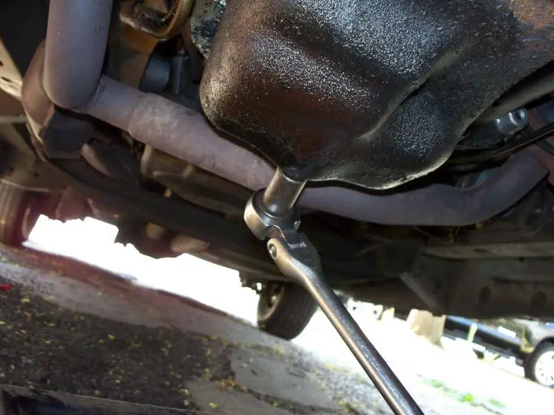

The subject may seem simple, but some people have asked how to replace oil. This is for all of the people who want to know but are afraid to ask. :D You place the vehicle on ramps so that it tilts back, then remove the drain plug:
Always check the condition of the seal around the drain plug, and replace if necessary. This is the oil filter:
