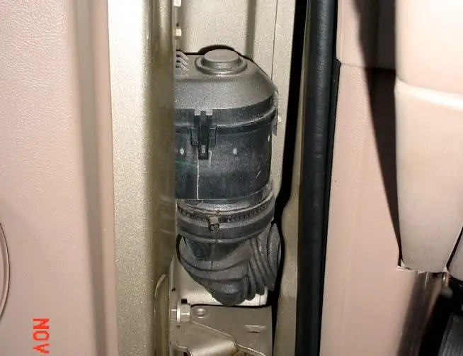

So before you do, check the connector to the front door to see if you have power there. It's a bit tight there but accessible. Often there's a break in the harness TO this connector, right in the flexible elbow boot area. Anyway, remove the cap on top of the connector, remove the bolt and separate the two halves. Check pin #7 on the vehicle side for power. If there's power there check pin # 7 on the door side for continuity to the O/LG wire @ the mirror switch plug ...... okay, you knew that. If you have no power on the vehicle side wiggle the boot around and see if it gets power. Report your results back to us.

silly question. ignition on or off... I tested with ignition ON, as it should work like this no matter what, but should i see power there when off? is ignition required for the mirrors to funtion?

Should be hot all of the time. Let me make sure I'm right ............
Hot all of the time. It doesn't matter if the ignition switch is on or off.

Ncranchero!! My props to you. I removed the rubber wire cover directly beneith the connector, and found not one, but three broken and corroded wires about 3 inches away from the connector. the Or/Gr(power to mirrors), a thicker Black(unknown), and also a thicker yellow/black(the reason my rear right window wouldn't open. I thought it was a bad motor). thanks to you, two of my projects are now done with the help of a couple of 50 cent line connectors.
thanx man.

The black I'm sure is a ground. Sure glad to see you figure it out yourself without feeding the dealership!! Glad to have helped.
