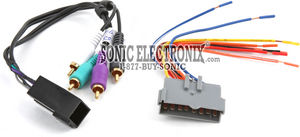

If its the JBL system (and not the MACH system, which is different), you can choose between;
-A harness that bypasses the amp completely and uses the factory signal and speaker wires to power the speakers with the aftermarket radio's amp (sucky setup since the factory signal wires are THIN, also usually results in loss of subwoofer use)
-A harness that uses the preamp outputs of the aftermarket radio to send an audio signal to the factory amp/amps (good idea for stock speakers, keeps the factory sub) No change in wiring except for the harness.
-Scrapping all the factory stuff (radio, amps, etc.) and just throwing in an aftermarket amp or amps for the speakers and sub. (somewhat expensive, but best sound quality with new speakers and sub, and least amount of headache in terms of getting things to work with each other) You can keep the factory speaker wires and use them, simply swapping in the aftermarket amps in the same place as the factory ones.
Running new speaker wire isn't necessary unless you either have damaged factory wiring, or need larger diameter speaker wire for higher power amps and speakers. For four speaker systems without a sub (or when using an aftermarket sub and sub amp), sometimes running new speaker wire from the head unit is less hassle than messing with all the adapters, though.
So where can i find something like this?
-A harness that uses the preamp outputs of the aftermarket radio to send an audio signal to the factory amp/amps (good idea for stockspeakers, keeps the "factory sub) No change in wiring except for the harness."
You can get harnesses online, whether at car audio sites like crutchfield, or even through regular retail sites like amazon. You'll have to price compare with shipping and see what the best deal is.
You can also buy them at your local car audio shop, but they tend to be much higher priced. Walmart sells the basic harneses, but not that type of amplifier integration harness.
The amp harness you need is going to depend on the system you have. If it's a real JBL system like the 91-94's, you just use the same harness as those. If it's the later system like the 96-97's, you'll need to use that. Basically, pull your factory radio and see what the connectors look like before buying.
Metra 70-5510 Amplifier Integration Harness Ford Explorer 91-94, (some 95's), JBL Audio system
Metra 70-5603 Amplifier Integration Harness Ford Explorer 95-97, JBL/Mach Audio system
If you do have the later system with the seperate tuner, it seems they're pushing another harness kit to bypass the rear-mounted tuner. I would think installing an aftermarket radio and unplugging the tuner wires would do it, but the tuner might be integrated into the same power and audio wiring as the amplifier. An antenna extension is also included so perhaps you can get around it if you wire up a different antenna that just goes to the head unit directly like in most other Explorers. If you must use it, the kit is
Metra 70-5061 Rear Tuner Bypass Kit Ford Explorer 95-97
Personally I would just pull the rear panel/door panels and replace the factory amp and sub with a nice 5-channel amp and an aftermarket 8" or 10" in a Q-logic enclosure (or a JL Audio Stealthbox/MTX Thunderform), and new 6x8's (or components) all around. It's more money and hassle than plugging in some wires, but the volume and sound quality are worth it. The factory stuff eventually blows up or falls apart, anyway. An amp integration harness should work if you just want a radio with aftermarket features without bothering with the amp/speakers or sub, though.

If you page up and look at Anime's post with the conversion kit photos... see the bundle that has the blue purple black and white plastic connectors... those (well like something that those would plug into). Like on an old stereo or cassete recorder... RCA jacks they're called.

I don't know which one is for your model, but looking at the photos that Anime posted, assuming it was the first one then you would plug the RCA connectors into you HU preamp outs. The other end (black plastic squareish) mates with the ford cable harness. The Grey plastic adapter handles the power and ground connecions as well as the amp turn on lead. The grey plastic connector mates with the other ford harness.
The benefit is that you don't have to cut off the ford connectors... if you should want to sell the car you could possibly get a factory radio from the junkyard and snap it in.
