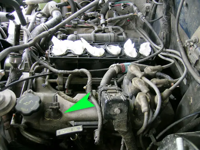

On the SOHC, as viewed from the driver's side of the engine bay:
(upper intake plenum removed)

from the drivers side
Quote:
Originally Posted by IZwack View Post
On the SOHC, as viewed from the passenger's side of the engine bay:
Unless your vehicle is set up for driving in the United Kingdom I believe that your photo was taken from the driver's side.

Woops sorry, edited original post.
