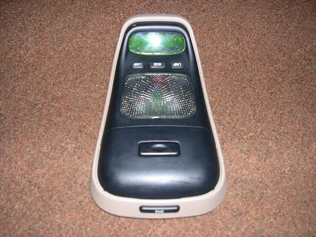

after inspecting the inside of the first console i bought i think you were right about the display.i founda # 191 resistor that had lost it's solder point on the pc board ....i could had fixed it i suppose but thats a big if ...but ,
i went back to day and found 2 more .one had the exact same color ( tan ) as my interior and the other was the same color as the one i first got ( blue/grey) but it was for a sunroof explorer ( 1996) .so i figured that to test one i would have to take a battery with me ( took a old lawn and garden tractor battery i had with me with me tools ) worked like a charm.
the tan colored one did not work but yet the one that came out of the sunroofed exploere did ! so what does any body with half a gumption do ?! i swapped gut from each to make one good working console that is now in the same color as my truck :D....i also got the sensor for the temp( just about could not find it ) i like it when a plan comes together lol.
only had to pay another dollar to get into the yard so my total cost for a nice new and in the same color ohc was ----> $11 (take that e-bay ! )
thanks again for your help ! all i got to do now is take it all apart and clean the piss out of the parts and slap some armor-all on there and it's good to go !

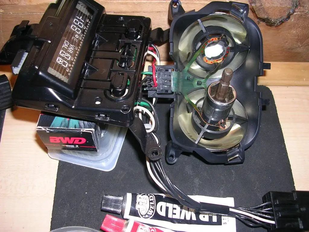

well after i got it all apart and cleaned it i noticed that the lamp had a lot of heat wear on the ribbon cable that supplied power to the bulbs ...pic ,
( the parts in red are where i glued it down basiclly like two wires that you have to have not touching )
i used some jb weld and lifted up on the cable where it sits on the fixture and basiclly glued it down in place .over the years and heat from the bulbs the material that makes up the cable has just worn out from replaceing blub ...but now they should last a little longer. i used a 5/8 socket to sit on top of the ribbon over night to help it lay flat on the fixture ...worked great!
this ohc is from a 96 model but the one i got the day before was a 98 i think but the fixtures were different and also used a different bulb ...but that fixture does not used a flat ribbion cable to supply power just wires ( guess thats why they changed the design ...the ribbon just plain sucks ).
...so i guess the would a be a good fix idea for 1996 ohc units !?

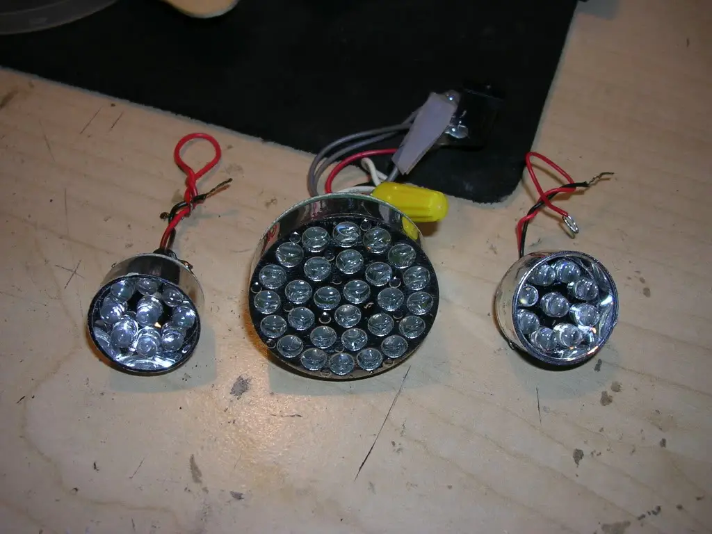

not sure about the bulbs being different. i know the display color is however (95-97, blue(ish) 98 and up, god awful green). if you want to go one step further, do a led conversion (make your own leds). i did that with mine, and its nice and bright at night.
you know funny you mention led's ..... i had these that igot out of some led flashlights i had laying around i was thinking of replaceing the normal overhead light fixture with these. they run off of 3 volts ,i had a universal power supply hook to them and they will just about blind you ....
i think if you goto a auto parts store and buy speciality led bulbs for automotive use they charge you out the wazoo but go and buy some of those cheap $2-3 led flash light they got up near the cash registor and with a resistor you can adapt them to 12 volt use easilly for cheap .
you would'nt know what resisitor cuts 12 volts down to 3 do ya !?
edit : btw i still have the lens from the first ohc hahaha...it's a blue green ... the one i showed has got the green,green lens ( matched my stock radio anyways)
