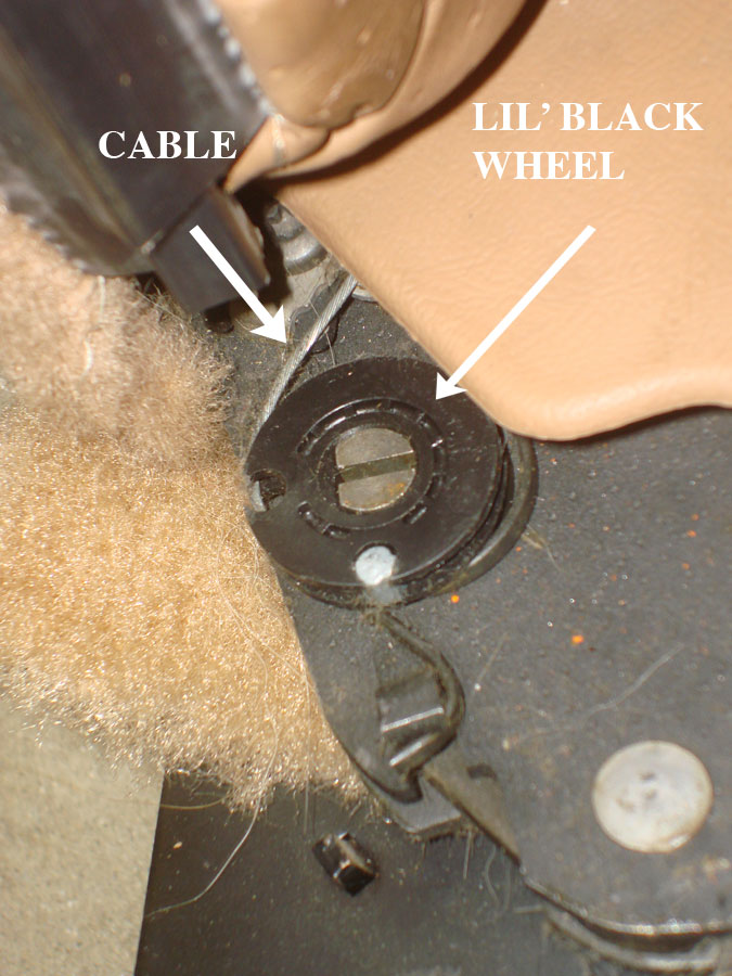

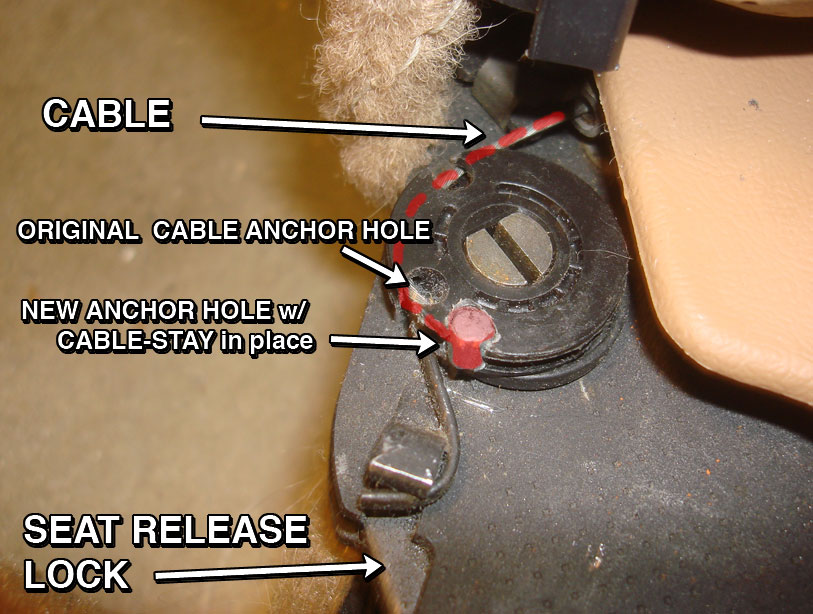

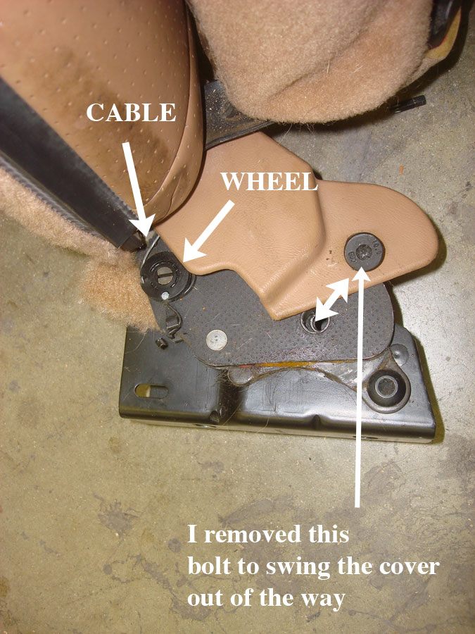

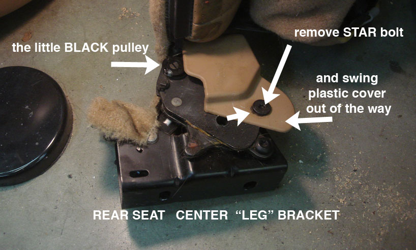

I have a 1996 Explorer and thanx to this thread, I spent the afternoon pulling the rear seats out to find that little BLACK WHEEL I think Jeff mentioned was the culprit!
I tried to find it without removing the seat, but my efforts were futile not really knowing exactly what I was looking for. Ours had a plastic cosmetic cover over it so we could not see the pulley while the seat was still in the vehicle. Now that the seats are out, I can easily see the little black wheel.
Once the seat was out, it was an easy fix.
I removed a star bolt that held on the plastic cosmetic cover and easily had access to the little black pulley. (see image and video links below)
With needle nosed pliers, I stretched the cable to see how much slack it now had, then I Dremeled™ a new anchor point into the pulley and just moved the cable's factory anchor-stay end into the new hole. Quick, easy, and works like a charm now! (I put a little hot melt glue on it too, just as an added precaution).
To make life easier for others looking to fix this same problem, I've posted some photos on-line and a YouTube video. (links are below)
Good luck to others sharing this problem.
