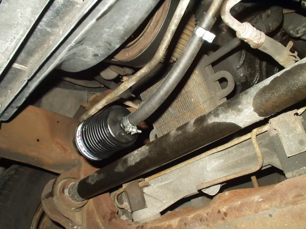

I was just reading another thread about adding a drain plug to the pan. I'm thinking of just draining the pan and topping off with during every other engine oil change and adding an inline magnafine oil filter. What type of drain plug do you recommend? Do I just drill a hole in the pan and use one of those self tapping plugs and just screw it in and out a couple of times to rid the shavings before putting the pan back on?

I just found out that it doesn't have a factory external transmission cooler so it is going to be a bit more difficult to install an inline filter. I'm going to have to cut the steel line and add the filter in between. I want to put it on the line that is returning to the transmission but I'm not sure which line is the return. Is it the line coming out from the bottom of the radiator or is it the top line. If it flows through the radiator in the same direction as the engine coolant then I would think that the bottom line is the return. Am I right?

I thought that I'd go ahead and send over what I posted. I didn't hear anything back about how to replace the reverse/forward o-ring so I didn't do it. I went ahead and changed the filter and put a drain plug in the pan. I then removed a section of the line coming from the transmission and added a Magnafine in-line filter. I took some pictures of the finished work. I found that 6 quarts came out of the pan, and that is after it sat for almost two days before I dropped the pan. I also found that the transmission holds 9.8Qts I believe that includes the torque converter. I am going to change the fluid again in 6,000 miles.

I have installed an external filter (I have auxiliary cooler) and that's what I did.
I did use a bigger FL1 filter (with remote screw base adapter), to minimize the pressure drop in the transmission circuit.
