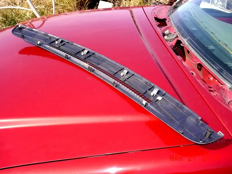

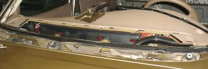

Use a long wide blade screwdriver, put a double folded towel over the dash pad to protect it.
This photo showing the dash slots indicate where the clips are and where to pry.
and the bottom side of the defroster panel

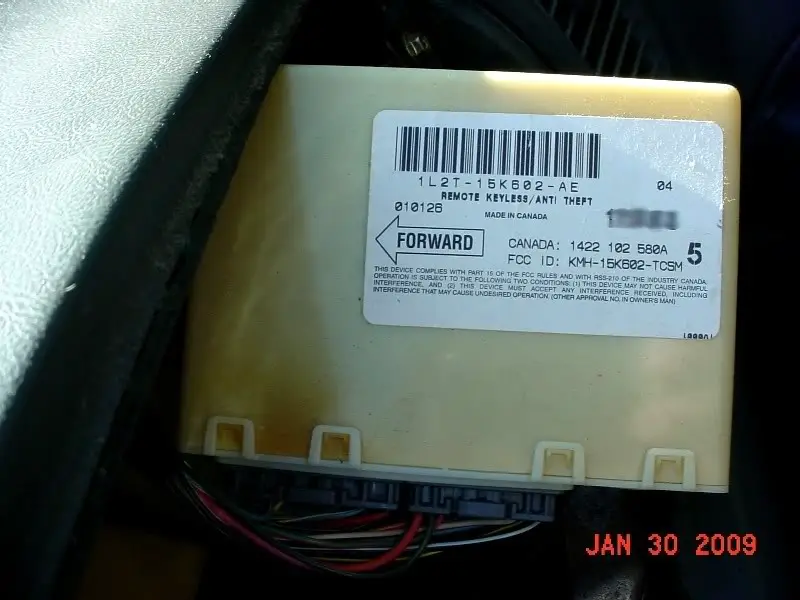

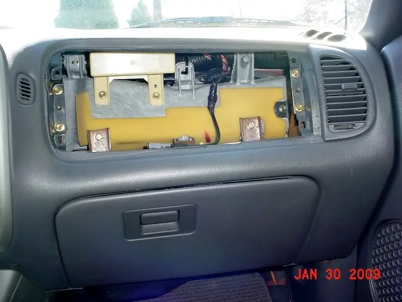

No, no STrac4me and 600remguy........It IS where it was told to be, on the Security Module. If you can't see the code through the windshield you have two other options. Remove the passenger side air bag to get to the module or have the dealer connect it to their computer.
On the regular Explorer the module is in a rear quarter panel location but NOT on a Sport Trac.
Here it is with the air bag removed ....... on my 2001.
The blurred out area is the code ....

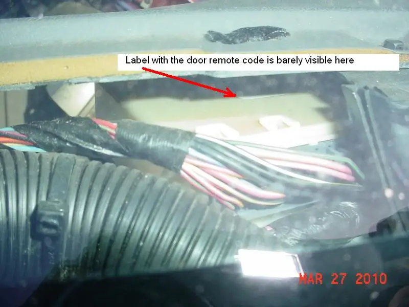

It was VERY difficult to see the number on my '002 but I finally got to where it was visible.

They're not easy to see. I could make out all but the first number. That left trial & error to get it but there wasn't but 5 choices.
