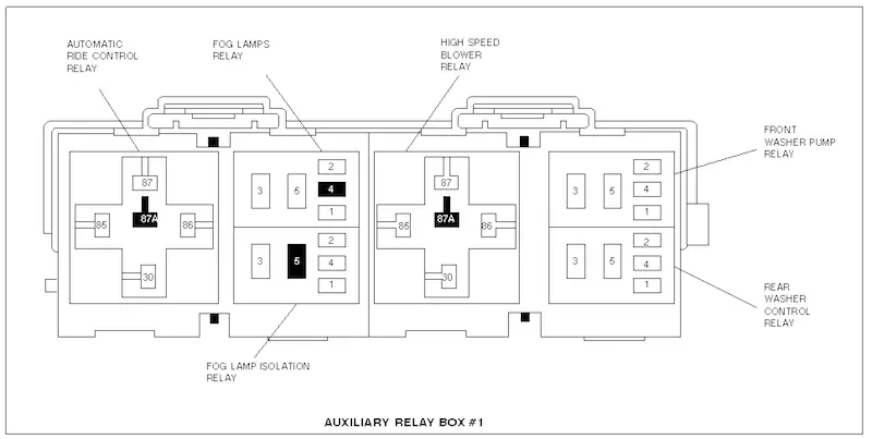

We have a problem with our washer pump not working .Well actually I tested the pump and it works but the system as a whole doesn't ,The wipers come on when the spray button is used but it doesn't spray.I tried moving some relays ( the ones under the air cleaner ) not sure which one is the right one if somebody has a pic and could point it out that would be great, and the fuse is good
My thought is this looks like a bidirectional pump, meaning polarity one way sprays the front polarity the other way sprays the back is this correct?
