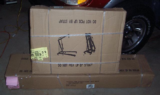

$140 plus tax at Harbor Freight buys what's in the photo below:

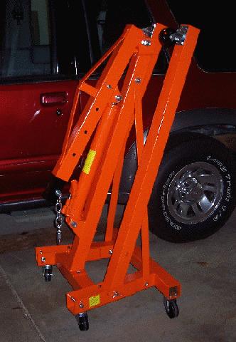

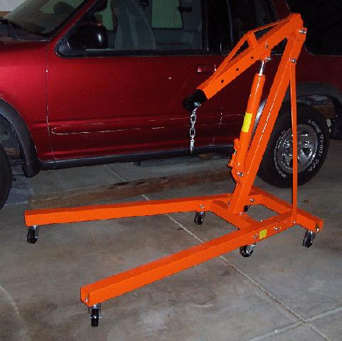

After about three hours of unpacking and assembly it transforms to this:
Which compacts to this:

Does anyone know about how much an SOHC V6 weighs?
Attachment 58088
Looks like they changed the design of the engine lift. Hopefully they fixed the problems!
As for the engine weight i would think at the least 350-400 lbs.

Thanks for the reply. I was thinking without the water pump, alternator and valve covers it would weigh less than 500 pounds. That means I can set the crane for 1/4 ton and have the maximum extension/lift height with the boom.

You should have no problems with that stand. I've had a similar design for about 10 years and it always works well.

I forgot to mention the only problem with the engine stands are that the engine is very top heavy be very carefull rotating the engine on the stand.

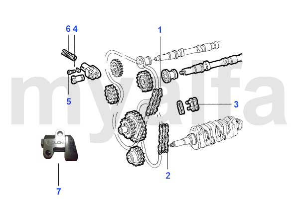

As I recall the photo below illustrates the chain configuration for my 2600 Alfa Spider.
The upper chain had a single gear tensioner on the slack side and no tensioner or guide on the traction side. The lower chain had a combination guide/tensioner on the slack side and nothing on the traction side. I frequently abused the engine by exceeding max engine rpm while driving in parking lot cone races and never had to replace any of the timing chain components.
I was only considering eliminating the traction side guide and shortening the chain accordingly.
Thanks for the info on the trans to engine bolts.
