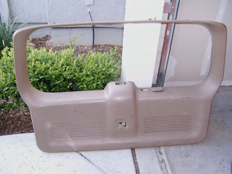

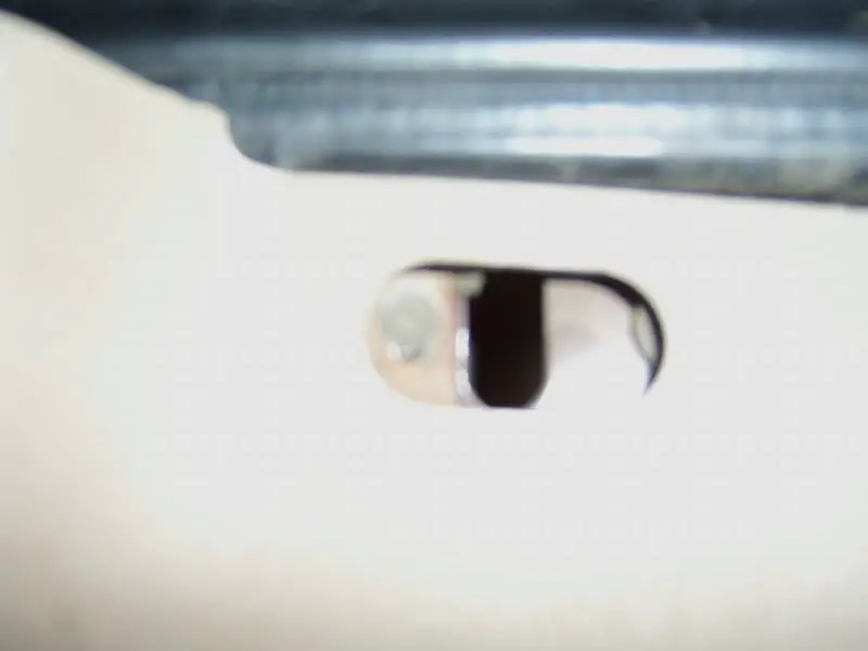

First, you will want to remove the strap held by 2 screws. Then you will want to remove the 2 hole plugs with a flat head screwdriver or putty knife. Under the right one, you will find a screw that needs to be removed:

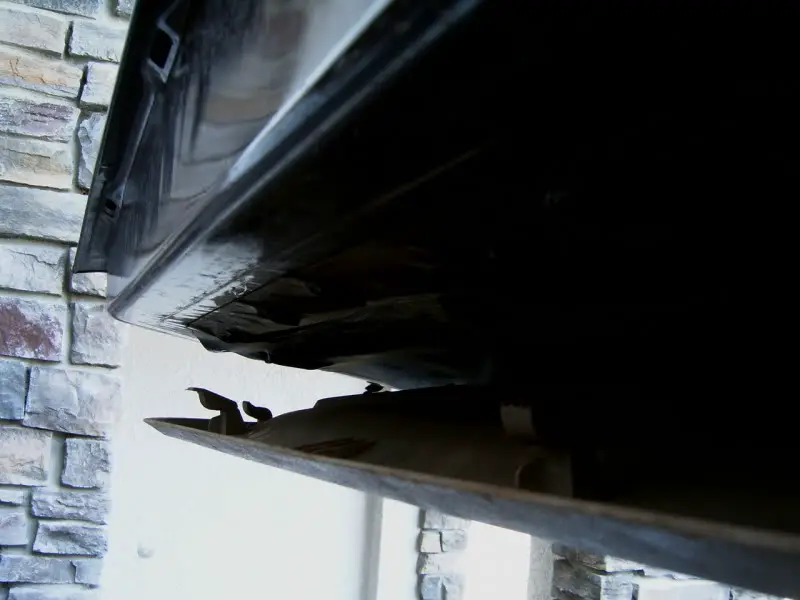

Next you will want to tug the top portion of the panel to release the fasteners from the hatch. There will be around 6-8 of these on the top half portion of the panel:
Next, you will want to slide the panel towards the front of the vehicle. By doing so you will be releasing 4-6 of these that are holding it onto the hatch:

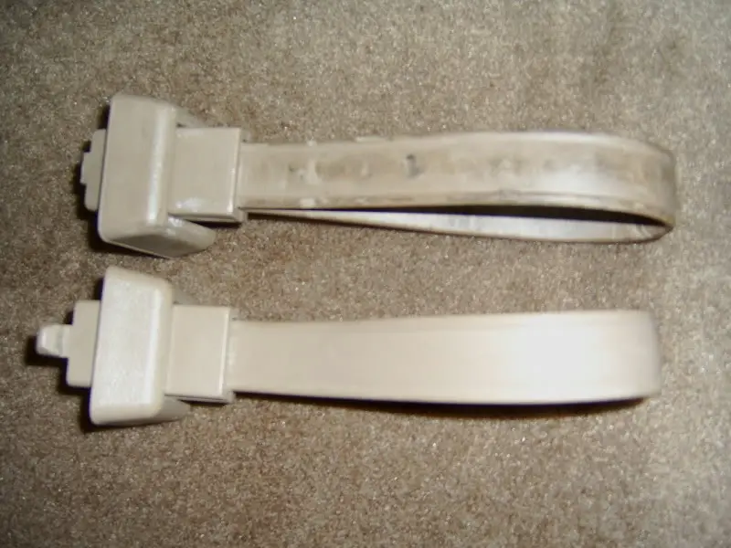

Here are my replacement and clean up pictures:
And all done:
