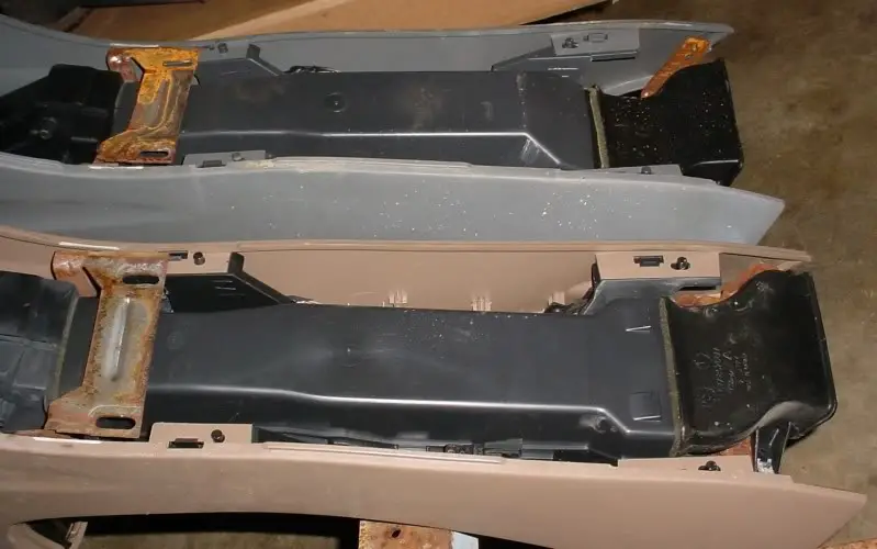

I stopped at the shop and looked at the two consoles on the way in just now. I didn't have my camera but I'll go back and photo the differences, there ARE some. The black vent duct in the console is shaped different on the end, Explorer to Sport Trac. I'll post a photo in a few minutes.
One thing to consider though, in all fairness, is that in the project both consoles were Sport Trac consoles. Personally I too thought the Explorer console would work but I haven't tried it out for myself.
Aint' gonna work .....................................as is. Here is the difference in the air duct, made to accommodate the crash module.
I didn't resize purposely so you'd have no trouble seeing the shape of the two ducts. Gray is Sport Trac, tan is Explorer.

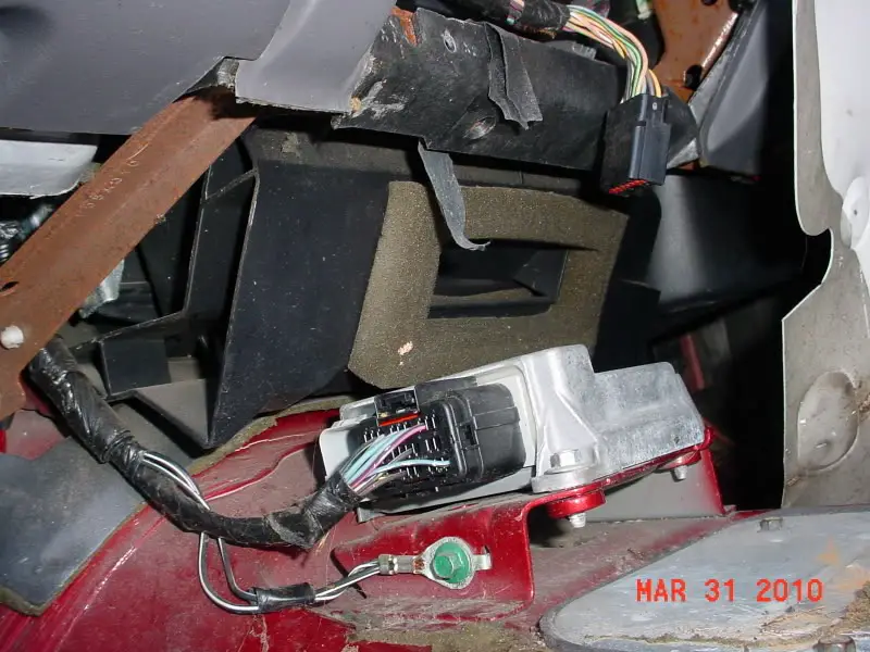

Here is the piece you need to connect the console to the truck HVAC.
Actually the piece on the heater looks very much like what you need. What did you remove from it? I believe the main issue is that console 2 piece duct. See how it recesses to avoid the RCM?
