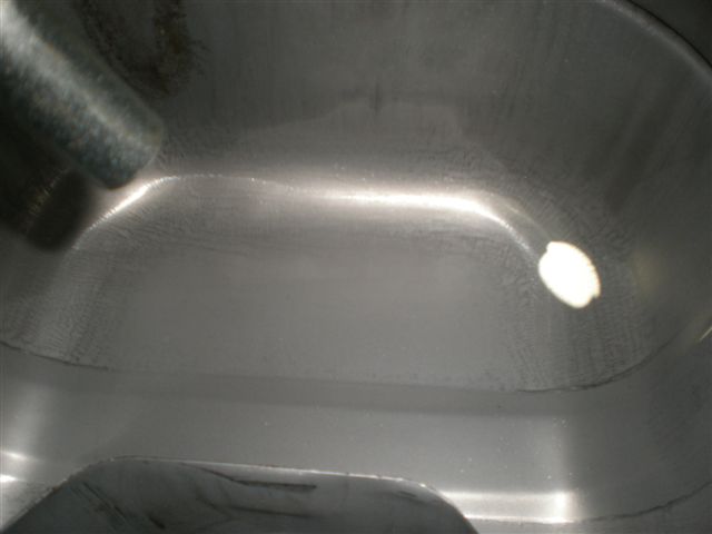

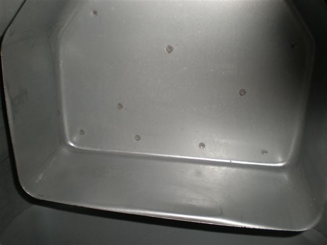

Here is another part of the solution...
When you get black junk from the filter it had to come from inside the tank...I fought this type of problem for months and killed 2 fuel pumps before replacing the tank...
The problem is the inside of the tank will rust and corrode...The fuel sloshes around and some of the rust flakes off and gets picked up by the pump...Unfortunately, the filter sock DOES NOT filter out most of the dirt and rust flakes that you found in the fuel filter...I had the tank cleaned out by a radiator shop and then lined it and it STILL found rust to pump into the filter...
The solution I came up with was to replace the tank, the pump, the filter sock in the tank, the external filter and next week the injectors that I had flow matched...The new tank is absolutely clean and rust free and the new pump will not have to pump solids into the engine at this point...
I will post pictures of the old tank and the crap I drained out of the filter so you can compare what you saw to what I drained out of my tank...Frankly I could have saved a whole bunch of money and aggravation by not messing around with the old tank and just replace the tank in the first place when I found rust in it...I thought the crap came from the gas I was using but I mounted a filter in the filler neck to pull out any garbage in the fuel from the pump and in 6 months I found nothing in the filler neck but plenty in the inlet side of the filter...
I found new tanks and pumps really reasonably priced...If you want the links I can post them... The pumps are 22.25 shipped and the tanks range from 68 for a 4 dr tank to 107 for a 2dr tank...

Compare the rusty tank to the clean one...
Imagine what the fuel is doing to the rust inside.. The rusty tank was cleaned out by a radiator shop in Nov 09...And this stuff is being pumped into the filter through the fuel pump and I guarantee you the fuel pump doesn't like pumping solids...
