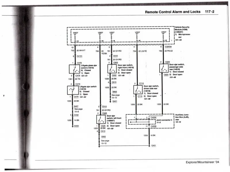

Lots more here than I could provide. However, my info is from 2004 literature, but I suspect 2003 already used similar means: I am scanning the Ford wiring schematic showing how the "door ajar" switches are wired in. Learned today, they are using a little computer called the Vehicle Security Module (VSM) which "looks" at the condition of all the door switches, to detect a door being opened when the vehicle is in the "secure" mode.
A system of "Diagnostic Trouble Codes" is used, just like the Engine Control Computer (PCM), and they are read by a special tester Ford calls the NGS tester. This provides a quick and accurate means of finding exactly where the trouble lies, and what caused it. Unfortunately, few of us will have such equipment available to us. Still, the door switches are "checkable" using an ohmmeter, just like all switches were even in the caveman days. So, I will attempt to post the schematic, hoping it will be legible.
If able to read it, the switch is CLOSED to ground, when the door is CLOSED, and is OPEn when the door is open. imp
