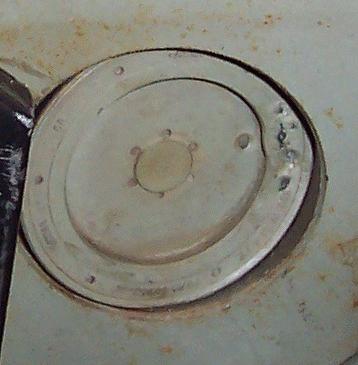

Jackshaft rear plug?
Which style jackshaft rear plug did you install? Did it have an all metal exterior like the original one shown below?

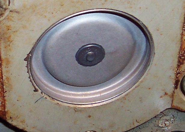

Or did it have a 1/2 inch diameter rubber center like the one shown below?
If it was the new style did you install it with the all rubber covered side facing in or out? How deep did you drive it in? Maybe its contacting the jackshaft rear sprocket retaining bolt. I could not find Ford instructions on which way to install the new plug so I chose to install as shown below.
It resulted in more clearance between the plug and the jackshaft sprocket retaining bolt.
