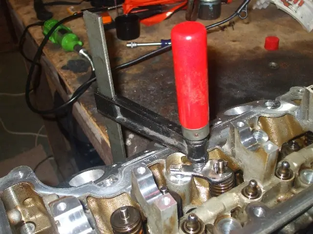

Sounds like the spring inside the lifter is sticking closed or not fully opening like it should. Ticking is the sound of a bad follower. I had to replace all twelve tappets twice. They are known for going south around 120,000 miles. The rockers you are refering too are actually cam followers. I would first try to rent a cam follower removal tool. This lets you remove the tappet without removing the cams. Then see if the valve has full travel.

if i remove valve spring wouldnt the valve fall down in cylinder?, also never seen a rocker with no stud or anything holding it there, just the cam sitting on the roller, very weird

The tool does not remove the valve spring, it compresses the valve spring down without disturbing the keepers so you can remove the follower. The follower rides between the cylinder head and the camshaft, there is no stud or bolt holding it on. I had to manipulate the follower out from under the cam because the plunger on the tappet was recessed inside the tip of the follower. Those things don't out easily. That leads me to suspect a bent valve is not your problem but who knows.

when i has the follower out the valve spring was like depressed down from the rest i banged on it and it popped up, so must be at least hanging, but here where i am in ohio its cheaper to change motor than have head work done so im thinking of replacing engine i found 1 with 106k on it for 465$, just i have never done this on newer vehicle im assuming its kinda like old cars, torcque converter bell housing motor mounts radiator and harness? may do it myself

Here's a link to show you how to remove the follower without special tools. Just be careful and follow the video to the letter.
http://www.youtube.com/watch?v=mbqKWzhpsHQ
