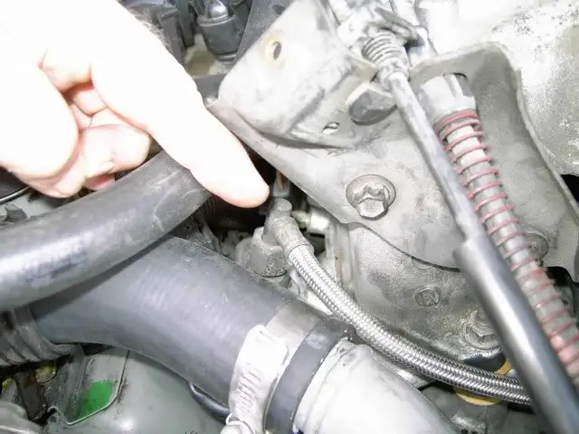

Thanks to all the post on this site and days of reading i finally figured out my problem. I have a 92 X sport 4X4 with 204k on it. It all started 2 weeks ago after i got my X back from a trans overhaul. I checked my mileage on the second tank and found out i was getting 11.1 mpg when before i was getting high 14 to low 15 mpg. and 2 days later my CEL came on. Thats when i showed up here and started reading. I learned how to check codes and what not to do. I had a P0173 code and figured it was my o2 sensor. I did NOT just go out and buy one but began checking and more reading. to make a long story short I think the fuel regulator is located on the passenger side front of the engine with a braided line attached to it and the vacuum line was disconnected. What was strange was that the nipple where it goes was not clean and shinny like i thought it should be and am not sure how long it was off. Now I'm code free and it didn't cost me a penny thanks to the wonderful people on this site that take the time to share their knowledge and experience.

photo of vacuum connection needed
can anyone post a photo of where to check this?
Would love a photo of this little trouble maker.
