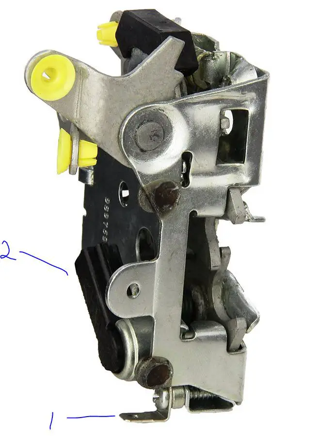

I am currently also dismantling the drivers door to replace the door handle and I can see that the door latch mechanism has two electrical connectors on it, as marked 1 and 2 below.
What do they do?
Could they be causing some mechanical pin to stay in a position that restricts movement of the mechanism for some reason and if so would removing the electrical connectors release it (I'm clutching at straws here!!)?

#2 is the door ajar switch. It shouldn't restrict opening the door. The little tip just pushes in and out.
Number 1 is the ground for number 2 afaik, it's been a minute since I looked into the connections.
Thank you.
I am now able to open the door. I disconnected the wires, which I now know makes no difference to the ability to open the door (unless the tip had seized in the out position??)).
