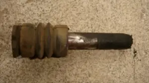

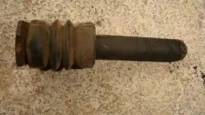

Hey guys,
I was servicing the front brakes on our new (used) 2005 Sport Trac. I didn't pay attention when pulling out the pins, but now realize the caliper pins are different. One has a rubber sleeve on it. Looking at the driver side caliper, and anyone tell me if the pin with the rubber sleeve is to go in the top position or the bottom? I will then assume the passenger side is the reverse.
Both caliper pins should have rubber boots on them IIRC.
Thanks. Boots yes, they are all in place, but one slider pin on each side has a rubber sleeve covering about a third of the pin when you pull it out of the housing. The pins (top and bottom) are different as one looks like a standard pin, and the other is milled down to accomodate this rubber sleeve. They don't show the pins in your diagram so it is hard to describe. Usually I pull pins out and they are the same top and bottom, but I didn't notice when I did these as I wasn't even looking at them when I pulled each out.
The second link looks like them, but it is odd as they show four sleeves in the picture. If you look at the pins on the left, those are the ones that accept the rubber sleeves, the ones on the right do not, so it would only be two sleeves. I have found other posts on google asking the same question, but still can't find an answer. I have the pins back in, but not sure if they are installed correct. Top on drivers side and bottom on passenger. I do get a slap from the front brakes now when turning (backing up).

Only ONE slider per side has the rubber sleeve - we aren't talking about the rubber boots. Read carefully.
This seems to be an eternal mystery with as many answers as questions. Does the pin with the sleeve go on the top and the pin with the flat spot go on the bottom, or the other way around. One post on the forum seems to come to a conclusion that they are opposites form driver to rider side!
No one form Ford seems to know - or can answer this question.
And YES - only ONE SLIDER PIN on each side of these Explorers (at least the 2002-2003) has a rubber sleeve cover most of the pin - again we are NOT talking about the boots on the end.

I have had nice even wear and no issues with the factory pins. drivers side= rubber sleeved pin on top and flat sided pin on bottom.
passenger side= opposite.

After carefully feeling for the differences in diameter of the holes receiving the pins, I'm inclined to agree that the rubber sleeved pins go on opposites on each side.
Since one of the holes is a bit larger on each mounting bracket, it seemed right that the rubber sleeved pin went in that hole and the all metal pin went in the smaller one. Tolerances were much better doing so. And since the brackets are identical (unlike the calipers) the larger hole was on top driver's side and bottom rider's side. Doing this seemed to make all tolerances much more even. When the all metal pins were in the larger hole it was very sloppy and the rubber pin was very tight.
So, I've come to the some conclusions. One rubber line per wheel, and though it may not matter whether it's on top or bottom to do it's "job", it does matter per wheel which pin the rubber sleeve goes in. I think the information given on the other discussion here on the forums is right - opposites with the top pin on driver's side being the rubber sleeved pin.

I just went thru this with my 03 Explorer. Checked the factory service manual and Motologic (a mechanics resource).
The factory diagram shows the pin with the rubber sleeve to be on top. But that is looking at it from the back side of the driver's brake rotor. It's the same caliper bracket on the left and on the right, so if you set the pins in the way the factory shows you to (regular pin on the bottom, and pin with the rubber sleeve on the top), that is correct for the driver's side. For the passenger side, it IS the opposite.
Easiest way to do this is to assemble the caliper bracket and pins like the picture shows for both sides, and then just bolt the brackets on. You'll find that in order to bolt the bracket onto the right side, you have to flip it over. So yes, the rubber sleeved pin is on top on the driver's side, and on bottom on the passenger side.
I had regreased these a year ago, and when I took them apart today, I found that the one with the rubber grommet had seized. It wasn't water or rust or anything... the grease still looked good even. It was that the rubber sleeve had moved. So I'll be double-checking from now on, a few months after install. This had caused one pin to not move, and wore the brake pads unevenly on the caliper piston side.
This time, I used less grease. Just a thin coat. I made sure the pins were clean, and not greased underneath the rubber sleeve. I gave it a light coat of grease over the pin and rubber sleeve, and gently rotated the rubber sleeve/pin into position. This kept the sleeve from moving on the pin. We will see if this works. The scary part is that I'm pretty sure I did all this the last time too, and somehow my process led to uneven brake pad wear and a seized pin.
It is true that the two sleeves are different sizes. You can feel that they fit better when you assemble them as described here.
