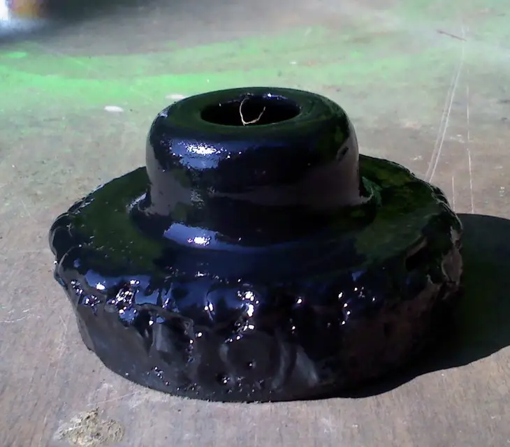

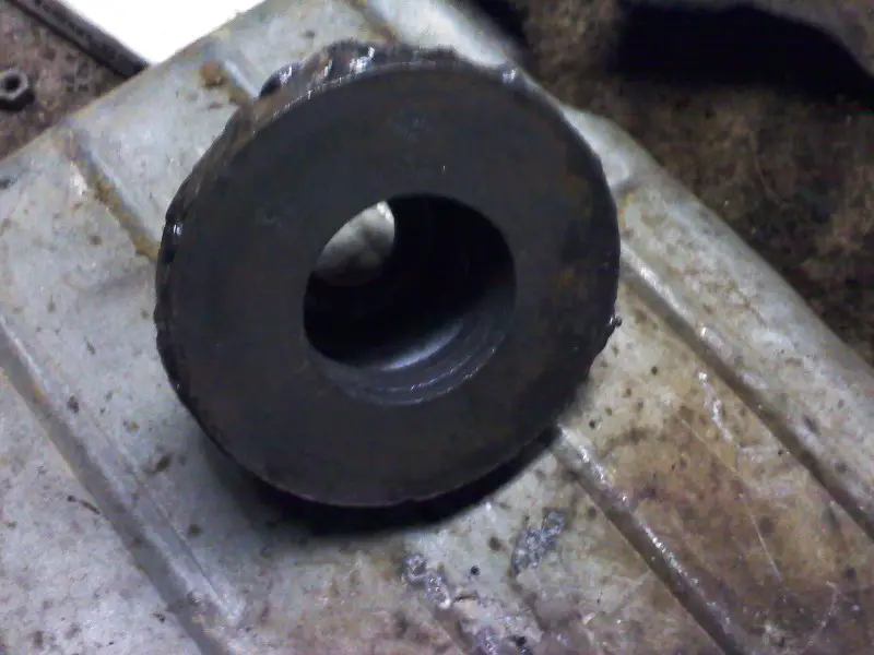

does anyone see a problem with this coil spacer i made heres a couple pics on drivers side is 4 washers(to make up for sag) 1/4 thick and pass is 3
they gave about 2"
oh and they cost me 10 bucks

Looks a bit ugly... but certainly not unsafe.
Oooh there's something I want to do. Maybe I will make some of my own when I get back in town. What did you make them out of??
He said he used large washers and welded them together so they can not shift. I like to use 1/2 inch thick steel but then that is what i have to work with washers work too
oh, haha, I guess I should read. I guess I didn't know they made washers that big. I guess the paint made it look like he made a mold and filled it with urethane or something, I don't know what I was thinking.
