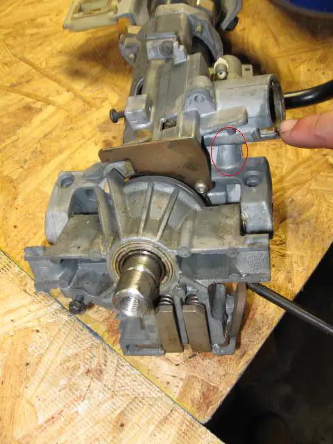

The first pic is the column as you see it sitting in the seat. My finger is where the key cylinder goes. There is a smooth round part of the casting just to the left of my finger under the lock cylinder case, going perpendicular to it. That is what is bored out, its circled with red.
The second pic shows the bore, again at the tip of my finger. Its about 3/4 of an inch deep. I used a piece of coat hanger. You do not have to remove the steering wheel mount. I have it removed for clarity.
Hope this helps, let us know how it works out.

Thank you so much for the advice and the pics. I was able to get the slid gear to move back and forth, but no luck with the key turning. I think the last cylinder key wafer colapsed in the keyway or the entire cylinder cratered inside. I will work on it tomorrow and get back to you if successful with the drill.
