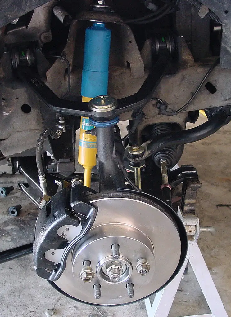

I just replaced the whole front end on my Mounty. It had about 150k miles and the suspension was really worn out. If the suspension is worn out, it's a good chance the steering system will need to be looked at. The Rack and Pinion is a Pita to get out, (easier if you remove the inner tie rods) at least in the V8 model. Here is a before and after:
I picked up the Upper Control Arms from Rock Auto, went with Raybestos Professional Grade. http://www.rockauto.com/catalog/rafr...?a=G-raybestos
They ran out of the lower Raybestos Professional Control Arms (at that time, it looks like they may have them again), so I pick up a set at the local Napa Store. Anything that required a core, I used a local supplier. I went with all heavy duty quailty parts, I didnt want to have to do this again for a while.
Before:
After:

Looks great... did you overhaul the entire thing? Looks like new bearings, bushings, everything down to the brake line... Exactly what I would like to do on my Mounty. Any additional pictures to share?

Yes, I replaced the whole front end, upper and lower control arms, cv joints, hubs, brakes, lines, Rack and Pinion Steering, tire rod ends. I plan on keeping the truck for a while, so it was a good investment.
I spent about $3k, but most of the cost was the wheels, tires, Bilstein Shocks & Xpress lowering kit.
It now rides better then it did when it was new. I have some more pics, I will try to post later.
