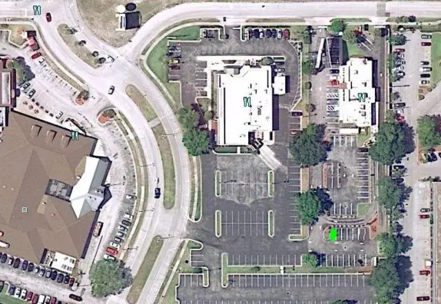

So I looked on google earth and got my wife to mark where she parked.
Not as far back as I thought, but still outside the drive through and main lot around the building.
