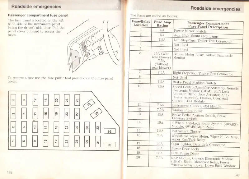

Smile 2001 Job 1 Sport Trac fuses and relays
Here's a scan of the pages from my manual for the fuses and relays for my 2001 Job 1 Sport Trac.

wich one is for the back window

Thx for the pics!

Is there an electrical diagram for the auxillary relay box on the passenger side? I'm working on a 2001 Explorer Sport and it seems that the Sport Trac manual matches exactly to it.
