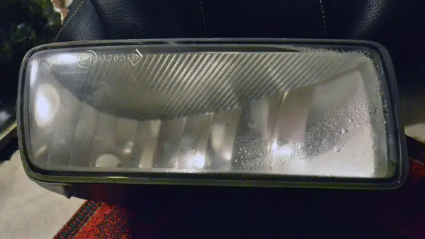

I had a lot of condensation in my drivers side fog light. popped it off, brought it inside for a couple days and it dried right up. been good for over 2 months now.
i also considered taking the little blue sticker off the vent hole but it appears to be a breathable fabric of some sort probably designed to let moisture out but not in.

I'm bumping this thread, because it's such a great fix (I hope). Coincidentally, my passenger side fog lamp had a LOT of moisture. When I pulled it, I found it was cracked, probably due to someone munching into a snow bank or something. I sealed the crack with epoxy and reinstalled it. Had moisture the next day! I figured the seal around the bulb base may not be good, so I bought new O-rings and reinstalled it... still have moisture! When my wife gets the truck home, I'll try and find that sticker. If it works, this thread will get another bump.
Edit: My wife got the truck home, and I pulled the lamp:
No wonder it isn't breathing:
I won't bump this thread again. I didn't realize everybody else in the world must have already seen this but me!
Edit II: No, this didn't do the trick, so I did some more research. I believe that fabric I pulled off is "Gore Tex". When the lights are turned off, the inside of the lamp cools causing a vacuum to draw outside air in. If the air is moist it fogs up inside. The Gore Tex fabric allows air in without the moisture. I don't think the O-ring on the bulb socket can seal 100% due to the high vacuum created. Unless that base is sealed with silicone it can't be a truly sealed unit.
My next attempt will be to find a new piece of Gore Tex to cover that small vent in the top. My theory is the piece I pulled off was clogged by the glue used to hold it on, and air was being sucked in from the bulb's base instead.
Edit III: No Gore-Tex to be had locally, so I cut a small piece of "Omni Shield" fabric from my Columbia jacket. Hopefully it will perform like Gore-Tex.
Here is my quick method for removing moisture from the lamp:
To compress the tabs holding the lamp in the bumper, I use three 1/2" long sections of 1/2" copper pipe:
Only epoxy I have lately is JB Weld, so I used that to attach a small rubber washer with 3/8" hole around the 1/8" vent in the lamp:
We'll see if that does any good soon...
Edit IV: This ain't gonna work. "Omni-Shield" is waterproof. Their fabric comparable to Gore-Tex is "Omni-Wick Evap".
So, I'll put the lamp back in and wait till I get some real Gore-Tex fabric. If my theory is right, I won't see any moisture in the lamp as long as I don't turn on the fog lights...
Edit V: Well, my theory must be a steaming pile, because the lamp is steamed up within a few hours and I didn't turn them on.
I think I can buy a replacement for $30.00 shipped...
...yep, my problem is solved for $31.57. Good luck to everybody else!

Received my "solution" from Auto Lighthouse via Ebay. Now, it's one thing to buy cheap Taiwanese junk, which is what these replacements are. It's another to receive a POS that's already been "installed". I should say, attempted to install. The one I got had one of the three retaining lugs broken off. The missing half of it was not in the packaging, so it wasn't broken in transit. I swapped a retainer from the old lamp and installed it using grease to help it slide in. After it was in, I noticed the other two retainers weren't holding it in. Turns out the three tabs on each lug were crushed in, and couldn't spring out due to being cracked at their pivot points. All six of them on the two original lugs. Had to swap the old ones off my moisture filled lamp.
So, it's installed now, and remains to be seen whether it stays condensation free. But, I still have feedback to leave for Auto Lighthouse. I see he already has quite a few negatives, but they're dwarfed by the thousands of positives. Don't know if I should even bother. I'll leave it alone until I know whether this thing is going to fog up or not. From what I've seen of the negatives, it may be hard to get a replacement, but giving a negative now ain't gonna help. Just a head's up for you folks...

I just had a bulb blow up in my passenger side, which was also fogged up for a couple of years. I needed to get the shattered glass out of the unit, so I thought I'd pull it off the truck and shake it out.
While doing so, I had put my hand on the clear lens to push/pull it out, and squiiiitt!, off popped the lens.
Apparently the sealant had failed all the way around and had turned itself into a slime growing experiment. I've cleaned it out and cleaned the lens, and squirted some clear silicone sealer into the channel and re-inserted the lens.
I'll give it a couple of hours to cure. Then a new bulb....and then we shall see.
