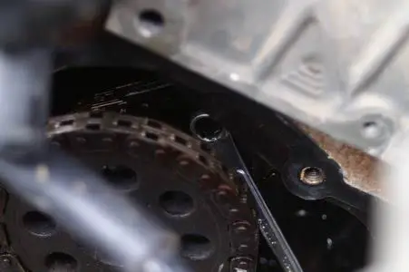

Inspecting the right timing chain guide assembly with the engine in the vehicle is rather difficult because of limited access. The hood prevents direct viewing from above and the heater blower box prevents viewing from the side. The use of a rectangular mirror at an angle may help. Taking photos with a camera may provide additional visibility. The photo below by CDW6212R shows a good guide assembly.
Sometimes the upper section of the traction side (the side with no tensioner) will be completely missing since it has no metal reinforcement and is susceptible to fatigue failure. See photo below.
The guide assembly upper mounting bolt may be flat on one side due to the chain slapping against it. Or, the guide assembly may appear to be intact but the lower section is separated from the upper section as shown in the photo below by cjmedina.
This can be detected by pulling upward on the traction side of the guide assembly. If it moves a quarter inch or more then it is broken. If there is considerable slack in the chain at the camshaft sprocket then the guide assembly is probably broken or the spring in the hydraulic tensioner is broken.

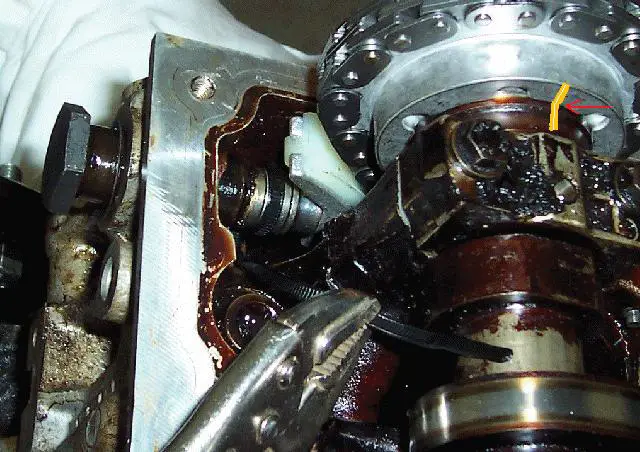

Note: It is important to position the crankshaft with #1 piston at TDC on the compression stroke prior to removing the crankshaft balancer or either camshaft sprocket retaining bolt. Special tools are required to determine TDC once the crankshaft balancer with crankshaft timing marks is removed. The SOHC V6 is an interference engine and rotating the crankshaft or either camshaft when a camshaft sprocket is loose risks valve to piston collision.

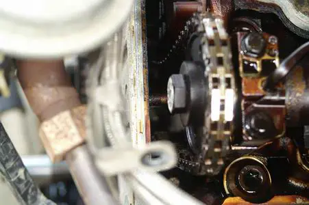

Inspection of the upper section of the left guide assembly is fairly easy because it is located at the front of the engine with good access.
The photo below by shelbygt shows the slack side of the guide assembly to be intact.

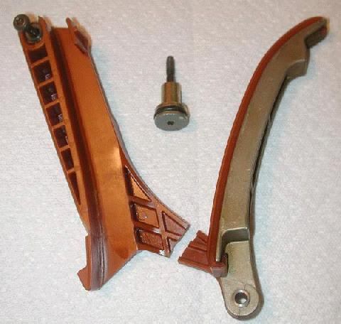

The photo below by shelbygt shows the failed traction side of the guide assembly.
The camshaft sprocket was detached for inspection.
The photo below by gold984by4 is another example of a failed guide assembly on the traction side.
If the engine contains excess sludge as shown below inspection may be a little difficult.
With the original style guide assembly either side (traction or slack) could be broken due to fatigue failure. With the upgraded guide assembly the plastic protrusion that contacts the hydraulic tensioner may be broken off. Excess slack in the chain at the camshaft sprocket indicates a problem with either the guide assembly or the hydraulic tensioner spring. The plastic sections of the guide are attached to the metal reinforcement with plastic clips instead of bonding. The plastic clips can break allowing vertical movement of the plastic that contacts the chain. Or the plastic may fracture leaving only the metal sections in position.

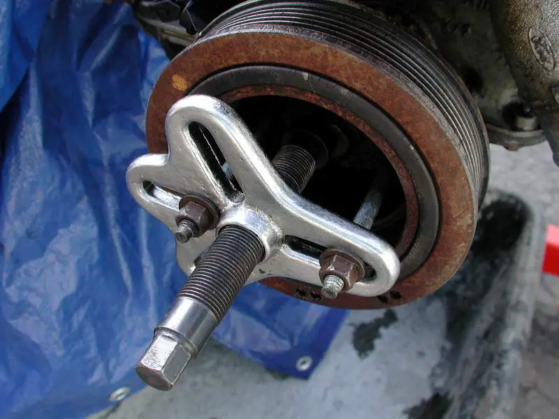

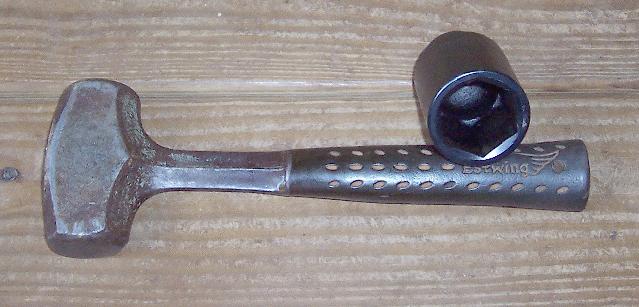

A crankshaft balancer puller is required to remove the balancer. Do not attempt to use a gear puller. A gear puller will damage the rubber like material between the inner and outer sections of the balancer. Crankshaft balancer pullers usually come in a kit that includes various diameter and length bolts to attach the puller to the balancer. Because of the depth of the balancer the standard puller kit bolts will be too short. They may be long enough to engage but will strip when force is applied to the center puller bolt. Suitable bolts are M8-1.25 of 90mm or 100mm (preferred) length. Some members use the stud bolts that attach the A/C compressor to its mount.
In order to remove the balancer the large bolt on the puller has to press against something contacting the crankshaft while the two smaller bolts pull against the balancer. See photo below by cjmedina.
The normal process is to loosen the balancer retaining bolt about a half inch. Then install the puller with the center bolt pushing against the head of the balancer retaining bolt and the long side bolts attached to the balancer. The puller center bolt head is then alternately tightened with a wrench and hit with a hammer until the balancer is extracted far enough to reach the head of the balancer retaining bolt. Then the puller is removed, the balancer retaining bolt is loosened another half inch and the puller is reinstalled and the puller center bolt is tightened and hammered until the balancer once again reaches the head. The process is repeated until the balancer is free of the crankshaft or there are only a few balancer retaining bolt threads still engaged with the crankshaft. Then the balancer retaining bolt is completely removed and a longer bolt inserted. The longer bolt can be the same thread as the balancer retaining bolt but those are hard to find and expensive. Instead, I use a smaller diameter (3/8 inch) bolt that does not engage the female threads on the crankshaft and is long enough (5.5 inch) to seat in the bottom of the bore for the crankshaft threads. By this point there is little force required to complete the extraction of the balancer because there is only a small amount of surface in contact with the crankshaft.
It is hammering the puller center bolt head (impulse) that results in extraction of the balancer. The side bolts just apply the tension determined by how much the center bolt is turned.

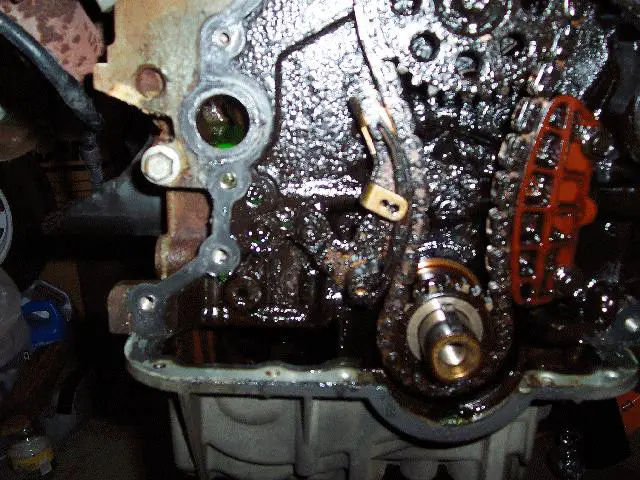

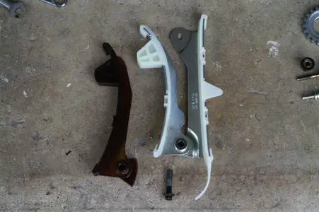

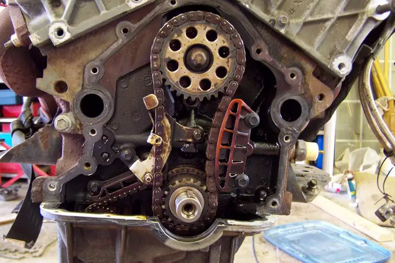

The photo below by CDW6212R shows a good (original style) primary tensioner and guide.
Also visible in the lower left of the photo is the balance shaft guide. The balance shaft tensioner is below the guide and not visible because of the installed block cradle (upper pan).

Often it is obvious that the primary tensioner has failed as shown in the photo below by White98.
However, in the case of leaf spring failure it may be necessary to attempt to deflect the primary chain to detect the failure. In the photo below the chain is deflected by the tensioner but still loose against it.
Even if the primary tensioner has not failed, if it is the original 3 leaf spring style with the small base I recommend replacing it with the 6 leaf spring style with the wide base as shown in the photo below by shelbygt.

With the front cover removed a small portion of lower section of the left guide assembly is visible. Make sure that the "finger" next to the lower sprocket is not broken as shown in the photo below by gold984by4.
I suspect it assists in oiling the chain when the engine is running. Restricted access to the left guide assembly lower mounting bolt is also available.

In general, the process consists of marking the left camshaft timing components relative to each other prior to disassembly in a manner that will allow restoration of their relative positions after replacement. It assumes that the front timing cover has been removed as described in previous post #4. It also assumes that the primary tensioner and guide has been replaced (if required) as described in previous post #6.
The improvised tool shown in the photo below is suitable for preventing rotation of the jackshaft sprocket while tightening or loosening the jackshaft sprocket or camshaft sprocket retaining bolt. A scrap bolt with washers on both sides of the chain link is screwed into the head. Another scrap bolt with washers is passed thru a hole in the sprocket and chain link and secured with a nut.
The improvised tool is shown in the loosening configuration. For tightening the jackshaft sprocket or camshaft sprocket retaining bolts the chain is attached to the left head instead of the right head.
Make sure #1 piston is at TDC on the compression stroke. The protrusion (nub) on the left camshaft for the camshaft position sensor should be on upper side of the camshaft.
In order to remove the left guide assembly it is necessary to separate the camshaft sprocket from the camshaft. With a solvent clean the rear of the camshaft sprocket and the camshaft hub between the sprocket and the thrust bearing in an accessible location. Then make a line with a permanent marker to identify the relative position of the sprocket with the camshaft. After the ink has dried use an awl (or something similar) to scratch a line down the center of the ink line as shown in the photo below identified by the red arrow (right sprocket shown but left sprocket is identical).
The scratch mark is more accurate then the ink and less likely to be accidently removed. This line is critical for aligning the sprocket with the camshaft.
In order to remove the left guide assembly it is usually necessary to separate the camshaft sprocket from the chain. With solvent clean the front of the camshaft sprocket and chain in the vicinity of an accessible area. Also, clean the timing chain and block in the area between the jackshaft sprocket and the head. Mark lines with a permanent marker and an awl as identifed by the red arrows in the photo below.
The accuracy of these two lines is not critical since the teeth in the sprocket will align the chain when engaged.
Install the improvised tool described above to prevent the jackshaft sprocket from rotating counter-clockwise (chain attached to right head with bolt).

Remove the cassette upper mounting torx bolt using T30 bit.
Using a 10 mm box wrench loosen the cassette lower mounting bolt as shown in the photo below by gold984by4.
When the bolt is loose it will be necessary to feed it thru a hole in the jackshaft sprocket to extract it. Use a magnet to keep it from falling.

Check balancer mark and pointer for TDC alignment.
Check left camshaft timing slot next to firewall for correction orientation as shown in photo below by shelbygt.
The slot is below the camshaft centerline and is parallel to the head surface that mates with the valve cover.

The new crankshaft damper retaining bolt is not long enough to reach the crankshaft when the damper is first positioned on the crank. Ford uses a special tool to install the damper. The photo below shows my "special tool" consisting of an on hand 36mm 6 point socket and a 4 lb hand sledge hammer.
The socket is larger in diameter than the damper retaining bolt head and it's round seat. I "tapped" the socket with the hammer until the damper was far enough onto the crankshaft that the new retaining bolt could screw in at least a half inch to eliminate the possibility of stripping its threads. I continued tapping and screwing until the damper was seated on the crank.
Install a strap (chain or pipe) wrench to smaller diameter of balancer avoiding crankshaft position sensor timing teeth.
While preventing rotation of crankshaft with strap wrench, torque new balancer bolt to 44 ft-lbs +90 degrees

can you change harmonic balancer with out these tools? or will timing get messed up?
Balancer can be removed without Timing anything, It is Keyed. Be careful with your Camshaft Sensor though. Its the one Mounted right at the Balancer. You DO NOT want to hold your Ballancer where the grooves are. The sensor uses those grooves to check location of Crank. You will need a Harmonic Balancer Puller and 2 long M8 - 1.25 90mm or 100mm Bolts (preferably)
See Photos Above On how to Remove.
I was just wondering because I replaced my harmonic balancer, and spun the engine from the flywheel, without harmonic balancer in place, I was wondering if that can throw the cam timing off.
You should be fine. Long as you have not loosed any of the Timing Sprocket Bolts. The Balancer is keyed it will only go on one way. Just make sure the Crank Sensor is aligned up correctly.. The old engine i took out of my 98 Explorer Had breen rubbing the Balancer.
if any of the jackshaft chains or front and rear cassette chains jump a tooth or become loose do to damaged tentioners will it cause loud rattling or knocking sounds i know it would screw the timing but would that cause these sounds. other than the knocking or rattling noise the engine actually starts up right away and seems to run ok. im so confused on what the hell is going on with this engine. i know there is like 4 or 5 chains inside this engine. its a 97 explorer with 4.0 v-6 SOHC engine. Can some one please give me some insite on whats going on in there
The primary timing chain tensioner and guide may be replaced without retiming the camshafts since loosening or removal of the jackshaft sprocket is not required. If the jackshaft sprocket retaining bolt is loosened the camshafts must be retimed since the compressed valve springs may cause the camshafts and jackshaft to rotate. Normally, the OTC-6488 timing tool kit is required to retime the camshafts.
I have no first hand experience with the balance shaft tensioner or guide. I believe the guide is easily replaced but replacement of the tensioner may require removal of the block cradle (upper oil pan).
