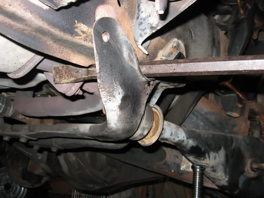

Here’s what my passenger’s side bushing looked like. If yours is destroyed like this you will want to replace it.

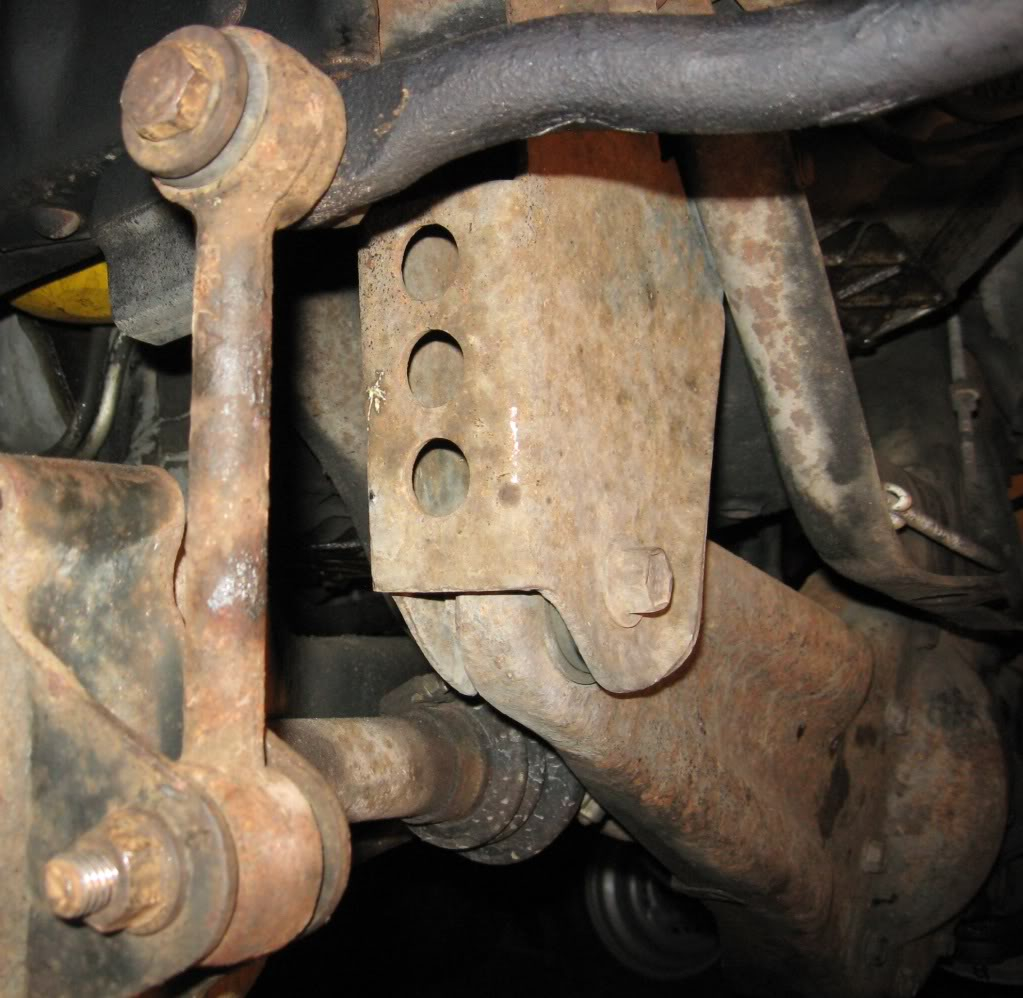

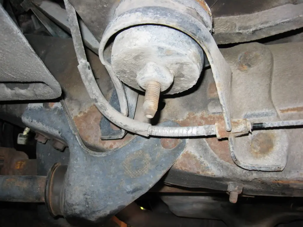

Here's the driver's side view. The rivets we want to get at are behind the parking brake cable. There’s another set on the passenger’s side. We need to remove the parking brake cable. Do this first, because if you use your brake to keep your car from sliding like some, it will fall over if you remove the cable later. You must block up the car.

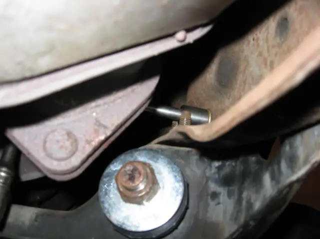

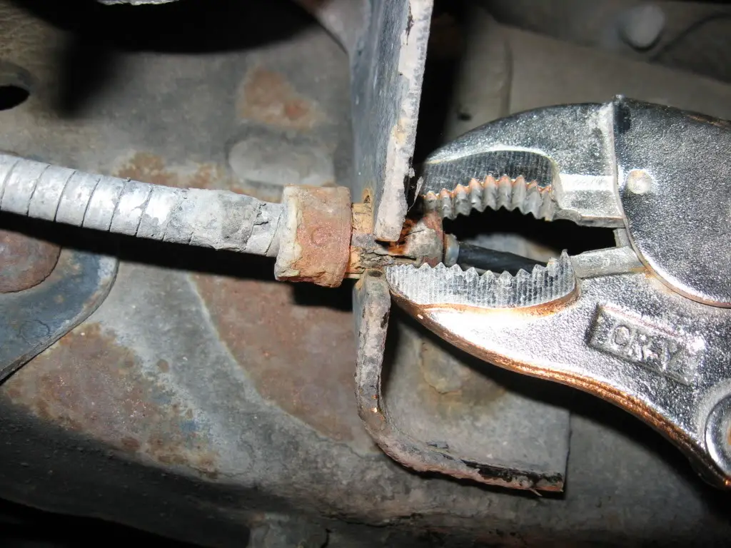

To disconnect the parking brake cable, you need to get enough slack to pull it apart at the CABLE TENSIONER (above).
To demonstrate slack, give the cable a pull. Notice how it slides out from each end?
Pull the cable out of the frame here. After that, there’s another clip holding the cable about a foot up in the wheel well. Remove that, too. You should now have enough slack to pull the tensioner apart.
NOTE: If you cannot get the slack you need, try using clamps to help. With the cable fully assembled, give it a pull below the driver’s side door. See where the cable slides out of the clip? Clamp it to keep your tension. Use a cloth to avoid damage to the plastic. Pull it by the tensioner. See how it comes out there? Clamp again. You now have more slack.

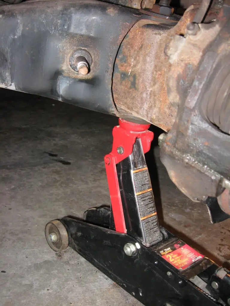

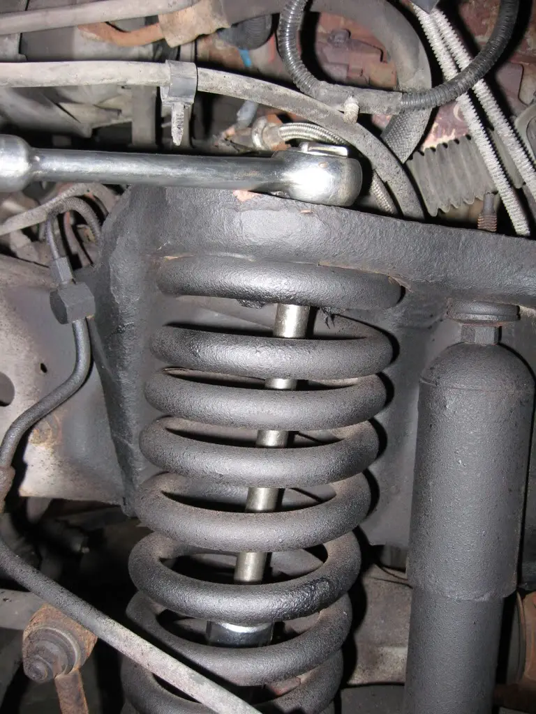

Remove the coil spring in the following way: FIRST, use a bottle-jack to COMPRESS the coil spring so you can get a socket in there. Here we are with an extender and a 1-1/8” socket.
Next, SWITCH to a floor jack. Just do this safely. Use the floor jack to LOWER the coil spring so you get enough clearance to pry it loose. Watch the brake hose. The coil comes out very easy once you get a little clearance.

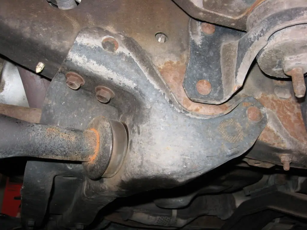

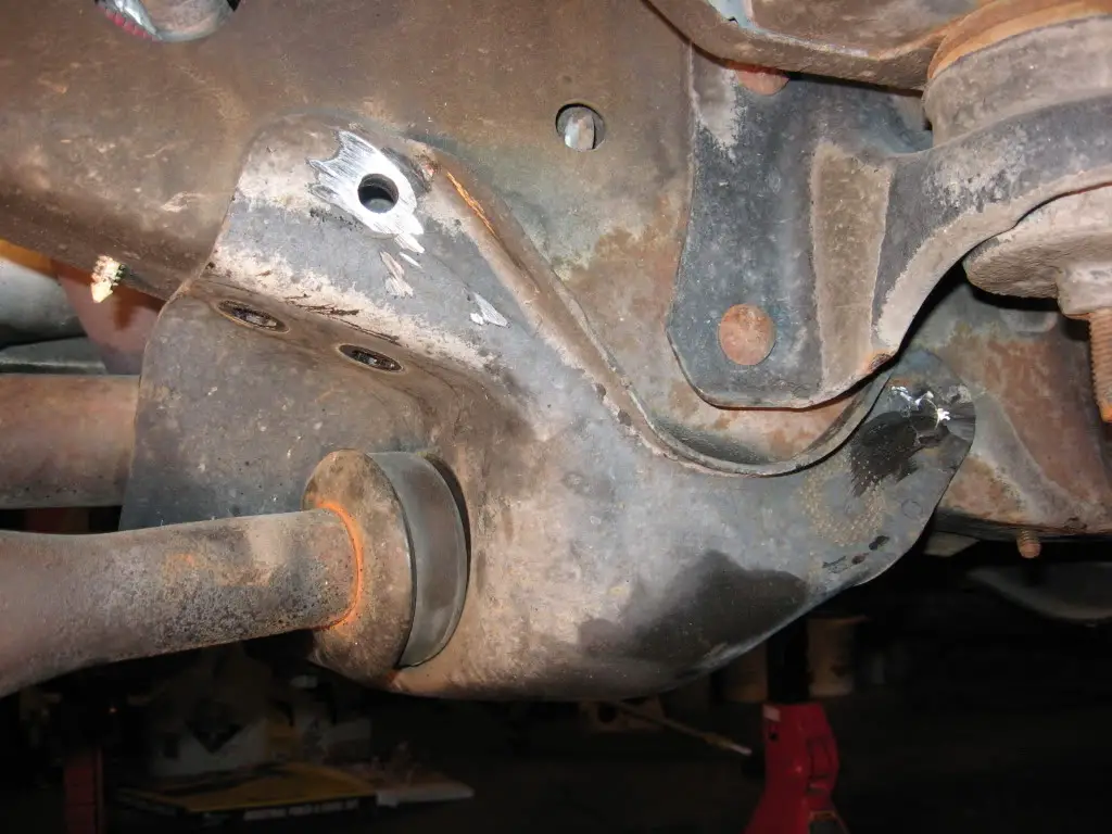

Now we can remove the rivets. There are two rivets on each side. Here they are above.
On the driver’s side, you must first remove the fuel filter case so it doesn’t get in the way later. You will know it when you see it. You had to remove it to inspect the radius arm bushings before starting. You did inspect the bushings before starting, didn’t you?
****TO REMOVE THE RIVETS:: I recommend you DRILL the rivets. Yes, I ground them here. Wish I had drilled them. Start it with a smaller bit. Then use a 7/16 bit. Use BLACK OXIDE. Not cobalt. Use a punch to get rid of the extra if there is any. Easy way, 10 minutes each side.
Here are the rivets, after they have been removed.
****NOTE ON GRINDING THE RIVETS:: If you really, REALLY don't want to drill the rivets you can grind them. However, you may run into complications. Grind them first, then punch them out once you have the heads off. Sometimes they won't punch out. One of my passenger side rivets stuck when I ground them. You will have to wait until you have the bracket removed and then grind the rivet flush with the frame, then punch it again. 20+ minutes of hot sparks everywhere per side, if it even works the first time. Hard way.
Once the rivets and bolts are off on both sides, pry off the whole darn frame piece. You don’t need to lean on it, hit it with a hammer, or jump on it or anything. A little finesse will work instead of getting paralyzed by your truck falling on you. Try this: use a bottle jack to maneuver the arm you are working on and pry the frame a little at a time, one side at a time.

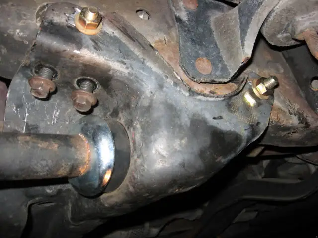

Since you read the directions above, you have already purchased some GRADE 8 bolts. Any old bolt won’t do. You need GRADE 8. But you already bought them, right?
Here’s how you might go about getting a socket on both ends of those GRADE 8’s.
EDIT:: In this pic there is no heat shield. You will have removed a little metal "cup" that covered the old bushing. Replace that just how it was, it's the heat shield, which keeps the catalytic converter from radiating heat onto the bushing, which could damage or shorten the life of the rubber. Thanks Mark!
Here’s everything back on. Shiny, huh? To get those grade-8’s on you really need to do some socket acrobatics but it’s worth it.

Great writeup. I did notice one thing though..
In this pic..
Quote:
Which is the passenger side with the new bushings.. You do not have the heat shield. It doesn't come with most RA bushing kits but is available. Its entire lot in life is to try to keep some of the heat from the catalytic converter from cooking the bushing.
~Mark

Nice write up! Great Pics! Hey, i thought that the 'replace the rivets with bolts" system precluded removal of the springs etc.
Why do the springs have to come out?
ernzo-
I removed the springs to get more play on the radius arms. If anyone is sure you can do this without removing the coil springs, let me know.

Mark ~
Thanks for the input, I updated the post and will post a new pic soon to avoid confusion.
UPDATE:
I simply added a note to avoid confusion. I have yet to find that part, I moved somewhere where there are NO JUNKYARDS! It's been OK So far but if you do this job just be sure to keep that heat shield, as over the years it will cause problems if you dont have it. It goes under the big washer.
