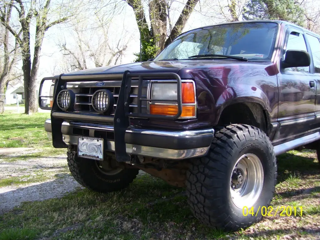

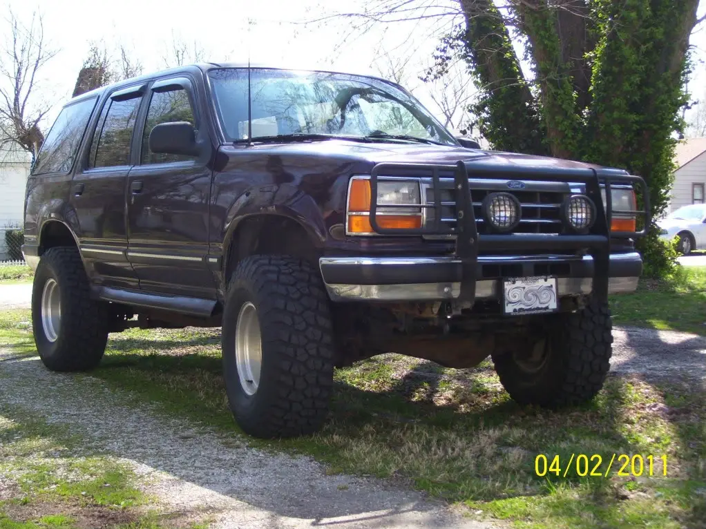

Pugly gets a new face.
Had an old center section of a Bronco brush guard laying around and decided to retrofit it on Pugly this weekend. The mounts on this are the type that simply bolt to the bumper bolts on top and face of a Bronco bumper. The Bronco bumper being taller than the Ex bumper, this worked out in my favor. I made some 1.5" wide brackets out of 4"x 1/4" angle. The top brackets have 1/2"w x 1.75" slots on both sides for adjustments. Bottom brackets are just single holes for straight bolt on to the frame rails. Being that the 1st gen frame rails are open in front (unlike 2nd gens) and the 3" body lift raises the bumper to the top of the rails, this was pretty simple as the bumper stayed on for bolting the lower brackets...
The light guards from the old guard on the Black Hole were made to fit on this guard to complete the install.
The lights look so much better on the guard then on the bumper itself.

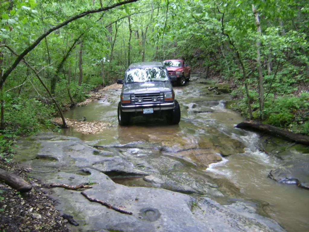

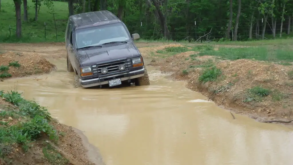

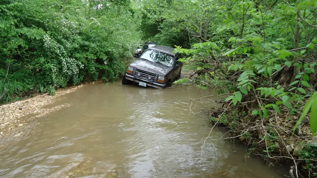

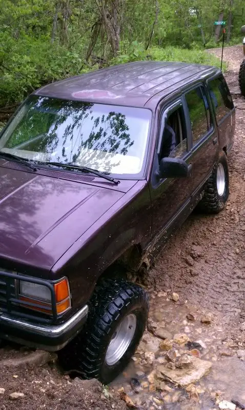

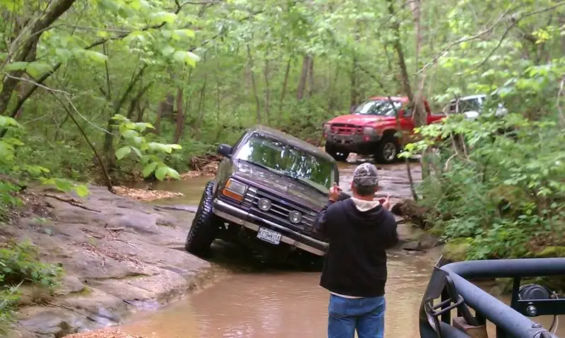

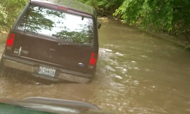

Pugly went wheeling again

What a trusting Papa !!!

Yep, the boy did all that piloting in those pics. He did pretty good his first time out I think. Only had to slap the strap on the rig once, with a little more experience, he could have got past that washout too. Good Times!
