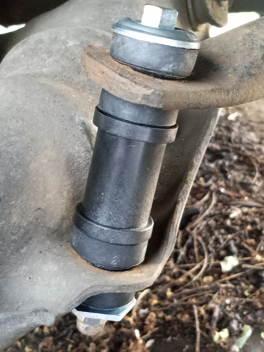

My stabilizer links were stolen, and obtaining new ones was a challenge for a 30 year old vehicle. Advance Auto Parts had two left with a lifetime warranty from Car Quest. They are a different design compared to other brands. I had to add an acorn nut to the exposed thread to conceal the exposed thread.
Of all things to steal...
